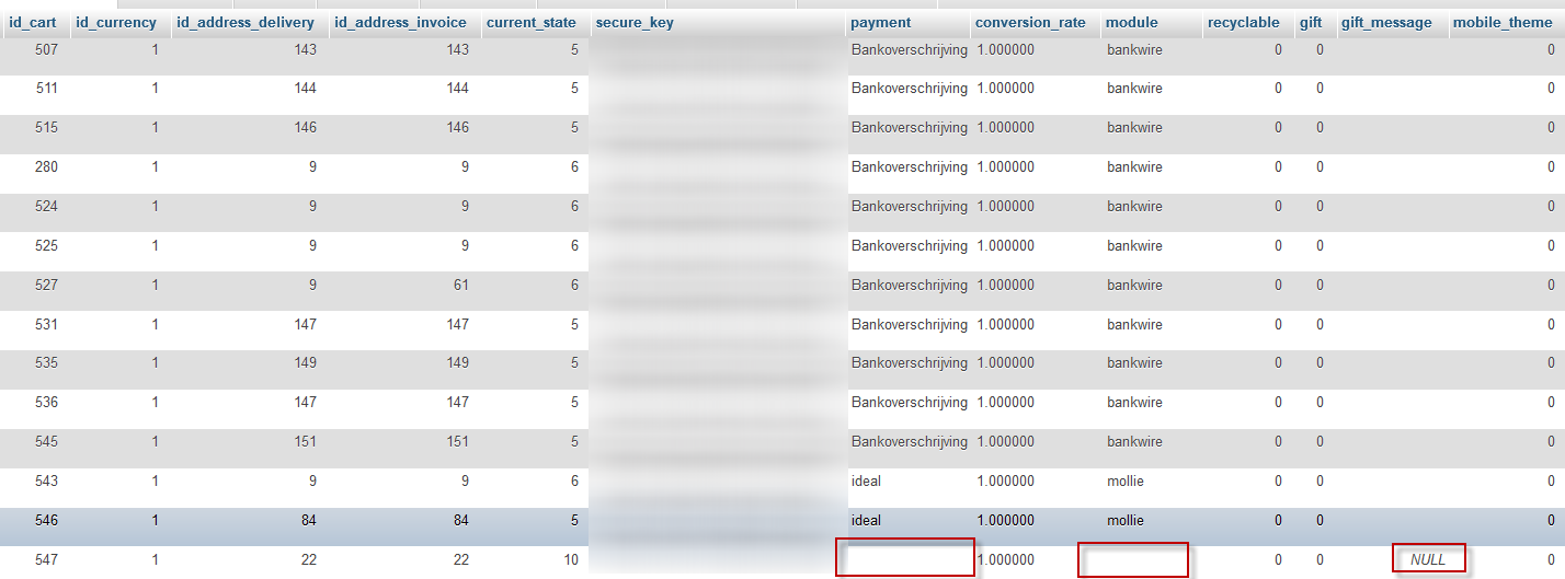

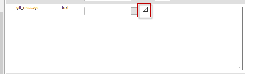

When I look in the database I see the order is there, but has no "Payment" and no "Module" (but that looks OO, because the order status is not yet changed. Maybe the Giftcard "is marked/cheked and has status "Null" but that does'n like to be the problem if you ask me.

I can not switch status (any status) manually if a customer pays via a bank-wire to the status payed (without having this error)
When  customer pays via iDeal then status can be switched.
It looks like the status changes does not update the type of payment is used.
