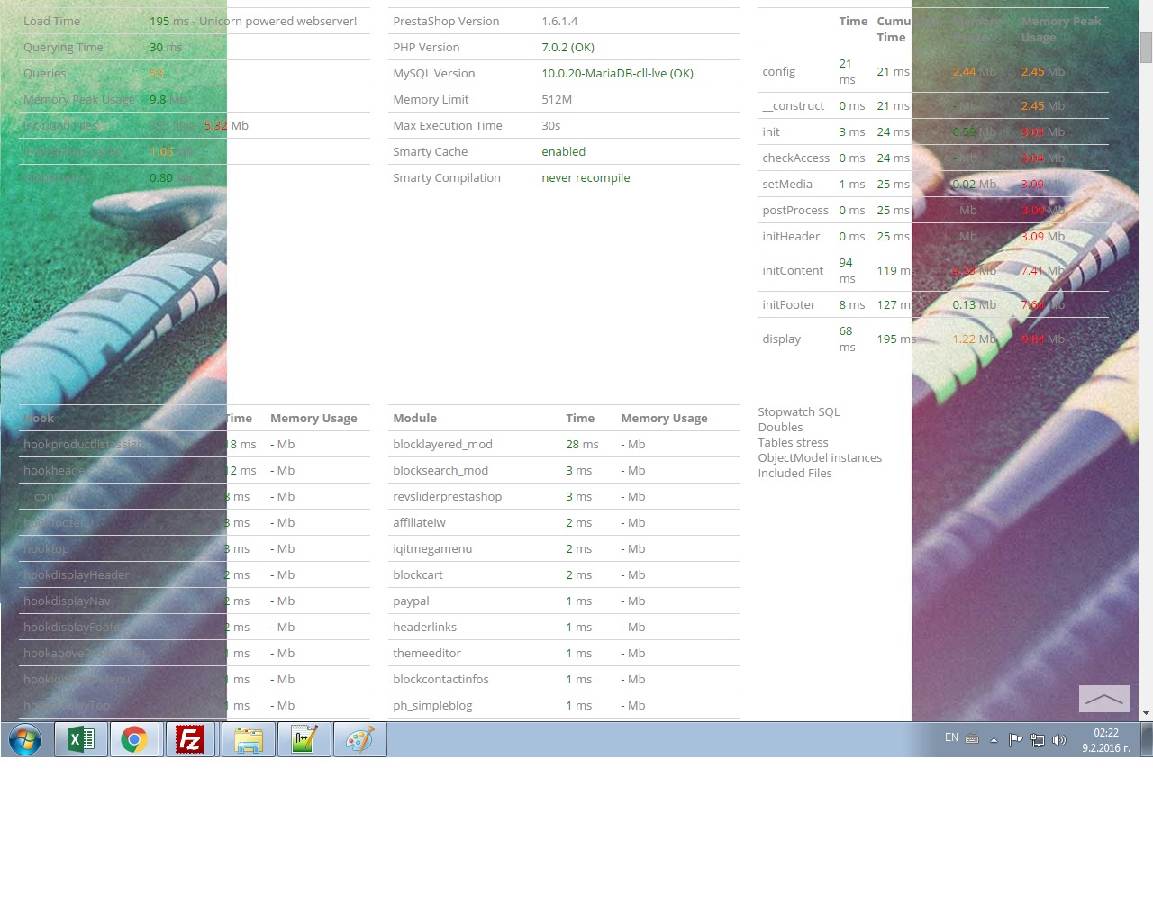

the.rampage.rado Posted February 8, 2016 Share Posted February 8, 2016 For me 1.6.1.4 is totally safe. I can't see blockers. HELLOO PRESTASHOP TEAM, PLEASE CAN YOU FIX YOUR APC CACHING!?! APC IS DEAD, LONGLIVE APCU!!! Please can you fix this so we can use APCu and not relay on backwarcompatibility!IT would be great!!!Please vote for this so the team can hear!Also is the forge currently supported and maintained?! Link to comment Share on other sites More sharing options...
the.rampage.rado Posted February 8, 2016 Share Posted February 8, 2016 (edited) I'm no programmer but I tried changing all apc_ to apcu_ as per the documentation but with no luck. APCu is running on the server it's seen in phpinfo but it don't show up as option in Presta. Probably the function for checking if it's installed is different but I can't find which one is it. Also tried back-engeneering it from php_apc.c but with no luck also Edited February 8, 2016 by the.rampage.rado (see edit history) Link to comment Share on other sites More sharing options...
the.rampage.rado Posted February 9, 2016 Share Posted February 9, 2016 I think I've pulled it!I was forgetting to change the adminperfcontroller to apcu and it was not detecting it. 1 Link to comment Share on other sites More sharing options...

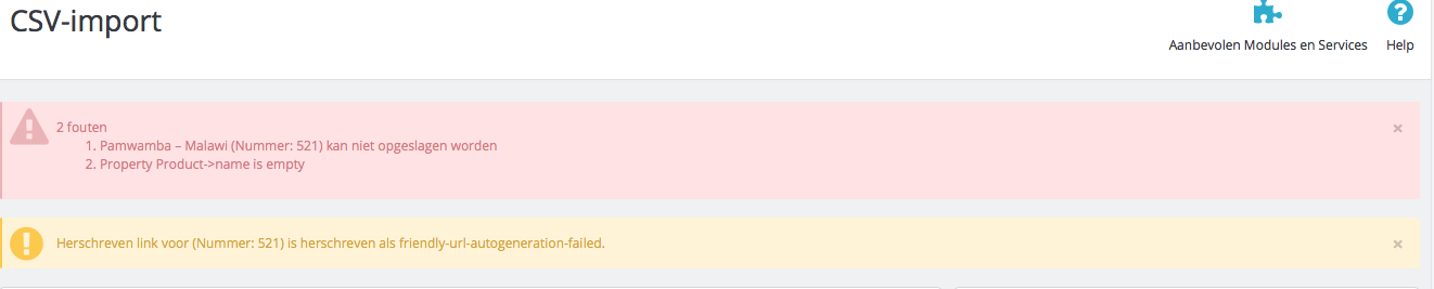

ListwySamochodowe.pl Posted February 9, 2016 Share Posted February 9, 2016 Hi, CSV import did not work - php 7.0.1, ps 1.6.1.4 ExampleCategoryName (ID: xx) nie może być zapisany Property Category->name is empty Przepisywanie URL nie powiodło się dla przyjaznego URL dla: Przepisywany link dla (ID: xx) był przepisany jako friendly-url-autogeneration-failed. after switching on php 5.6.16 it works ok. Regards Link to comment Share on other sites More sharing options...
[email protected] Posted February 20, 2016 Share Posted February 20, 2016 Same here, .csv import comes with message: Product property -> name is empty Switching back to php 5.6.10 made it work well again. I would like to use it on php 7.0 because it is faster, is there a way to work around? Link to comment Share on other sites More sharing options...
[email protected] Posted February 20, 2016 Share Posted February 20, 2016 Before coming to this conclusion, I tested with a 'fresh' copy of prestashop 1.6.1.4 on my mamp with php 7.0 and importing the sample data downloaded from the shop. I think I did not get an error message at first but when I used my own csv I did get, removing products in the shop while uploading new products I got it. After that I tried again with the sample data later I got the same product property -> name is empty. For both installations the problem was gone when I put the mamps php back on 5.6.10 I have trouble uploading the csv file, I get Error you aren't permitted to upload this kind of file, For now I can only upload a snapshot of it. The file works well again for me so I think it is not the problem but if you want it, tell me how to post or where to send it to. Link to comment Share on other sites More sharing options...

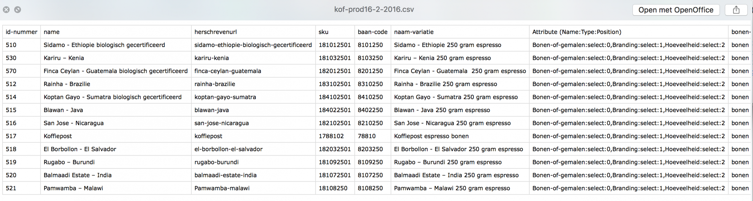

[email protected] Posted February 21, 2016 Share Posted February 21, 2016 Here's the zipped .csv kof-prod16-2-2016.csv.zip Link to comment Share on other sites More sharing options...

solskin Posted February 24, 2016 Share Posted February 24, 2016 Struggeling exactly with the same csv-problem. PS 1.6.1.4, PHP 7.0 Link to comment Share on other sites More sharing options...
solskin Posted February 29, 2016 Share Posted February 29, 2016 Is there any possibility to import products via csv with prestashop version 1.6.1.4 / php7 or do I really have to go back to php 5xx? Link to comment Share on other sites More sharing options...

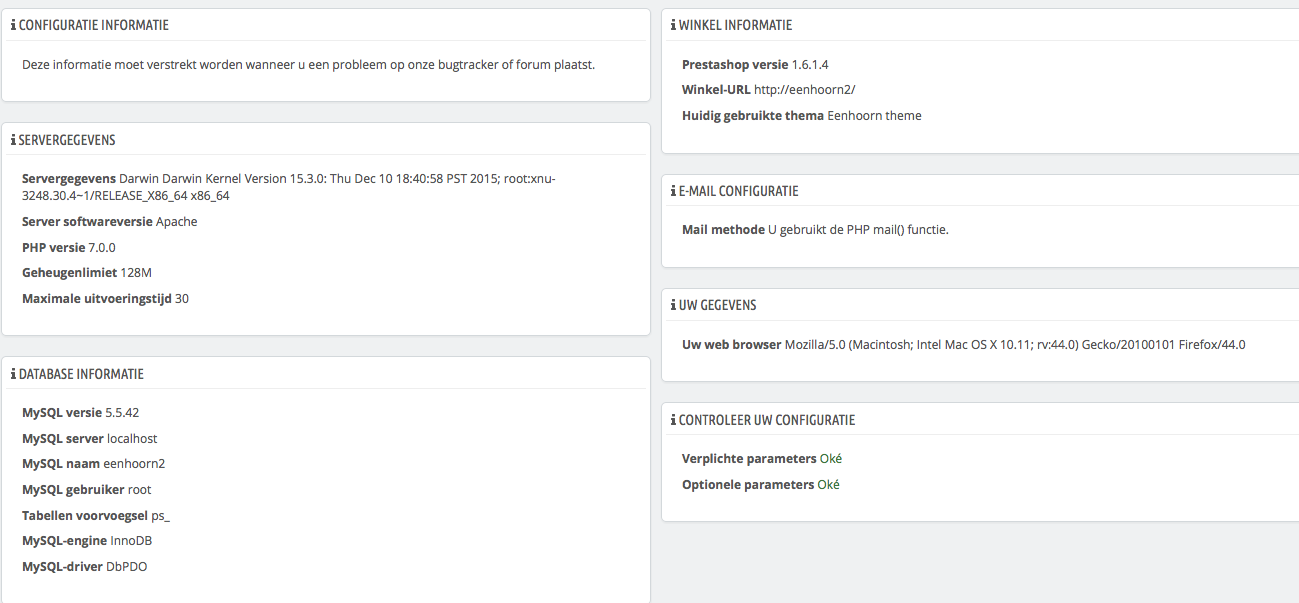

Carsten1971 Posted March 5, 2016 Share Posted March 5, 2016 Hello Some info on my experience With Prestashop 1.6.1.4 and PHP 7.x Fresh install no mods. I have one big problem, csv import does not work. It cant same my products and URL rewrite fails too. I changed back to PHP 5.xx and csv import worked again. - Carsten Link to comment Share on other sites More sharing options...
solskin Posted March 6, 2016 Share Posted March 6, 2016 I also had to change to PHP 5xx to do the csv-import. It hasn't worked with PHP 7.0.1 and PS 1.6.1.4. If anyone knows how to fix the bug or knows when it is fixed, please post it :-) Link to comment Share on other sites More sharing options...
Carsten1971 Posted March 6, 2016 Share Posted March 6, 2016 Need to be able to reproduce it first before I can go for a fix, but I'll give it another shot. Thanks @[email protected] for sharing your CSV! Could you please also share the information from the page "Advanced parameters > Configuration information"? That would really help me a lot with getting insights on the platforms used! Hello As I wrote before I can export a csv file, but when I import the same file again, I get an error, empty name, can't rewrite URL This happens with Version: PHP 7.0.4 MySQL version: 5.6.29 Server software version: Apache Works with PHP version: 5.6.18 Best regards Carsten Link to comment Share on other sites More sharing options...
[email protected] Posted March 7, 2016 Share Posted March 7, 2016 (edited) Need to be able to reproduce it first before I can go for a fix, but I'll give it another shot. Thanks @[email protected] for sharing your CSV! Could you please also share the information from the page "Advanced parameters > Configuration information"? That would really help me a lot with getting insights on the platforms used! I also switched back to php 5.x.x and all works well again (with the same .csv files) so I did not look into it anymore. Although on my MAMP when I change the php version to php 7.0 it is easy to reproduce. Here's a file of the config settings: With .csv I added 1 new product, see attachement to error message: Edited March 7, 2016 by [email protected] (see edit history) Link to comment Share on other sites More sharing options...

[email protected] Posted March 14, 2016 Share Posted March 14, 2016 (edited) Those messages show up when you forget to configure the columns. I'm not having any trouble importing the data on PHP 7.0.2, except for the image URLs not being available. csvimport.png What do you mean by configuring the columns? You don't mean assigining the columns to the right label (like id and price eg.)? Because that is all done well, as it works perfectly wel inserting all products into the shop with photo's and all (you can't get them cause shop is in maintanance). I can replicate the issue by changing the php on my mamp and re start, the I get failure when trying to add a new product, when I switch back and restart then all works again. It puzzles me. Maybe because I have an upgraded version in stead of a fresh install of PS 1.6.1.4? Edited March 14, 2016 by [email protected] (see edit history) Link to comment Share on other sites More sharing options...
