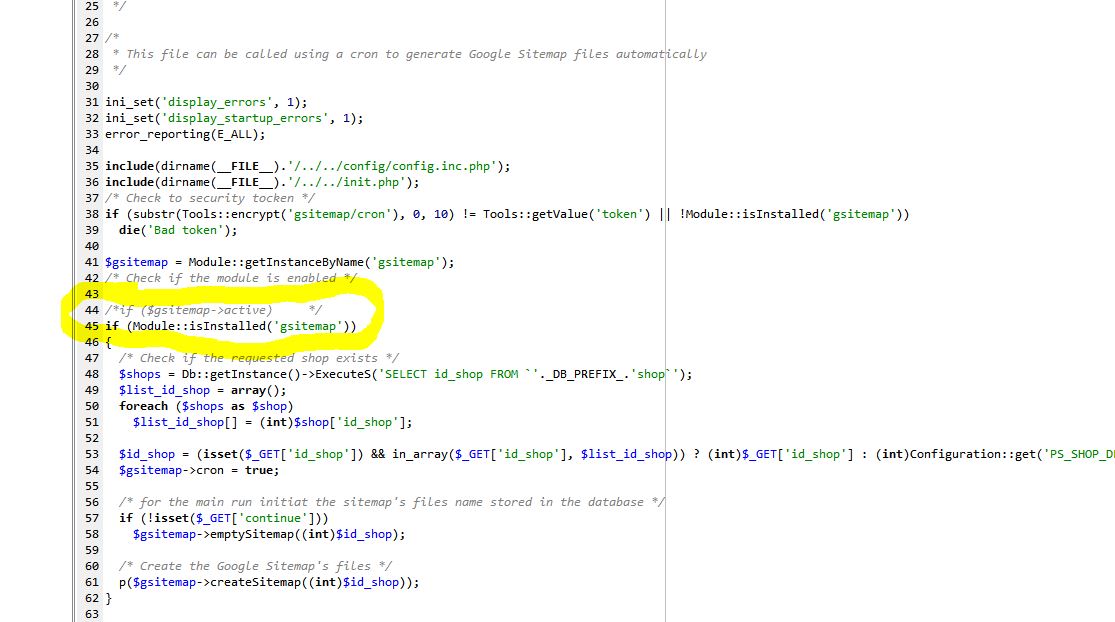

krtecek Posted March 27, 2018 Share Posted March 27, 2018 I changed in gsitemap-cron.php file checking of module install and it looks it works. See fig. Link to comment Share on other sites More sharing options...
