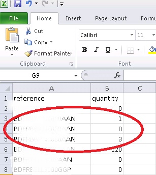

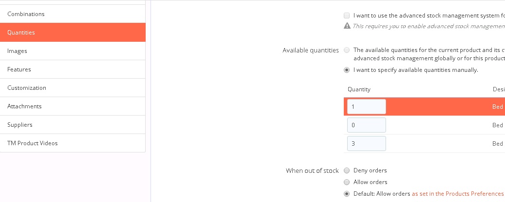

fritzelly Posted November 13, 2019 Posted November 13, 2019 Only issue I've found with the code is it doesn't update the quantity for products with attributes in 1.7 (made there was a DB change from 1.6), simple products are working fine but if your csv file contains something like some_reference_number, some_attribute, quantity 12345, Red, 10 12345, Blue, 5 12345, White, 2 Then it doesn't work, currently writing some code to pull the attribute values to know what to update Share this post Link to post Share on other sites More sharing options...
WisQQ Posted November 13, 2019 Posted November 13, 2019 (edited) Its based on reference, so you need to have attribute reference set in product attributes. I'm using this, should help you. $query= $db2->prepare("Select ps_product.id_manufacturer AS manuid,ps_product_attribute.reference AS REF,ps_stock_available.quantity AS QTY from ps_product LEFT JOIN ps_product_attribute on ps_product_attribute.id_product=ps_product.id_product LEFT JOIN ps_stock_available on ps_stock_available.id_product_attribute=ps_product_attribute.id_product_attribute"); And here is update. $query = $db2->prepare("UPDATE ps_product_attribute LEFT JOIN ps_stock_available on ps_stock_available.id_product_attribute=ps_product_attribute.id_product_attribute LEFT JOIN ps_product on ps_product_attribute.id_product=ps_product.id_product SET ps_stock_available.quantity = '".$newqty."' WHERE ps_product_attribute.reference = '".$indeks."'"); Edited November 13, 2019 by WisQQ (see edit history) Share this post Link to post Share on other sites More sharing options...
fritzelly Posted November 13, 2019 Posted November 13, 2019 Attribute names are stored in attribute_lang - unless you know and set the id of each attribute it's cumbersome Share this post Link to post Share on other sites More sharing options...
WisQQ Posted November 14, 2019 Posted November 14, 2019 2 minutes ago, fritzelly said: Attribute names are stored in attribute_lang - unless you know and set the id of each attribute it's cumbersome If you dont have reference set in each product attribute, then yes. You need to work around. It all depends how your products are set. Share this post Link to post Share on other sites More sharing options...
fritzelly Posted November 14, 2019 Posted November 14, 2019 1 minute ago, WisQQ said: If you dont have reference set in each product attribute, then yes. You need to work around. It all depends how your products are set. I'm not following you. The only table that references the attribute name is attribute_lang You don't call that table in your SQL so how can the code know what attribute value's stock to update? Share this post Link to post Share on other sites More sharing options...
WisQQ Posted November 14, 2019 Posted November 14, 2019 (edited) 9 hours ago, fritzelly said: I'm not following you. The only table that references the attribute name is attribute_lang You don't call that table in your SQL so how can the code know what attribute value's stock to update? Using Join in query you get value from tables. Attribute stock is updated based on attribute reference set in product combination. Example: Product have attributes like this. Size: S,M,L Color: White,Red,Blue Combinations will be like: S White, S Red, S Blue M White, M Red, M Blue L White, L Red, L Blue Each of these combinations is separate value in data base, so you assign unique reference. S White, reference: S-White-tshirt M Blue, reference: M-Blue-tshirt Doesnt matter how you set your reference could be like the above or with spaces. Then you can update stock based on this with query, i posted earlier. Edited November 14, 2019 by WisQQ (see edit history) Share this post Link to post Share on other sites More sharing options...
fritzelly Posted November 14, 2019 Posted November 14, 2019 Can you post an example of your product and combination csv? I'm failing to see how you can have individual references for each combination and still all linked to the main product. When you import combinations it uses the reference to link the combinations to the product, so if they're all different how are they tied to the product. Share this post Link to post Share on other sites More sharing options...
WisQQ Posted November 14, 2019 Posted November 14, 2019 2 minutes ago, fritzelly said: Can you post an example of your product and combination csv? I'm failing to see how you can have individual references for each combination and still all linked to the main product. When you import combinations it uses the reference to link the combinations to the product, so if they're all different how are they tied to the product. When you import combinations it links them using product ID, not reference. I'll share example csv later. Share this post Link to post Share on other sites More sharing options...
fritzelly Posted November 14, 2019 Posted November 14, 2019 Ahh, but your stock file, from say a supplier, won't have a product ID - that's internal to PS Share this post Link to post Share on other sites More sharing options...
WisQQ Posted November 14, 2019 Posted November 14, 2019 22 minutes ago, fritzelly said: Ahh, but your stock file, from say a supplier, won't have a product ID - that's internal to PS Yes, but i was talking about creating combinations for products with import builded in ps. Update is based on reference, which is provided in csv. So all i need from my supplier are 2 things: Quantity and Combination reference. Share this post Link to post Share on other sites More sharing options...
fritzelly Posted November 14, 2019 Posted November 14, 2019 Unfortunately one of my suppliers only gives a reference for the product and not the combinations Share this post Link to post Share on other sites More sharing options...
WisQQ Posted November 14, 2019 Posted November 14, 2019 16 minutes ago, fritzelly said: Unfortunately one of my suppliers only gives a reference for the product and not the combinations Can you share file provided by your supplier. Maybe i could help you with it. Try to modify product reference and use it in combinations just for your side of stock update. For example, if product reference is "tshirt_bear" change it just for combinations by adding value like size: "tshirt_bear_XL". After that u will be able to update your data base easier. Then you need to figure out how to read file from your supplier so you can update your stock. Share this post Link to post Share on other sites More sharing options...
fritzelly Posted November 14, 2019 Posted November 14, 2019 Unless I'm missing something there is no way to specify different reference numbers for a product unless you have the product ID to start with I could specify the ID manually when adding products but that will still require cross referencing the the stock reference with the product details to get the product ID I'm just finishing up the code to search by reference/product number based on the product reference Share this post Link to post Share on other sites More sharing options...
fritzelly Posted November 14, 2019 Posted November 14, 2019 I didn't realise you could set a reference when importing combinations - now it all makes more sense Share this post Link to post Share on other sites More sharing options...
WisQQ Posted November 14, 2019 Posted November 14, 2019 1 hour ago, fritzelly said: I didn't realise you could set a reference when importing combinations - now it all makes more sense Glad you found solution. It took me quite some time to figure this out. Share this post Link to post Share on other sites More sharing options...
