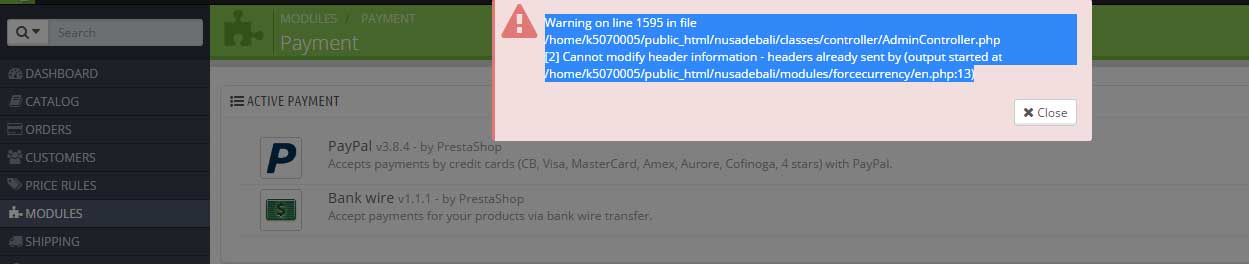

Help Me..!! I have Problem with this bug, I need help to solve this problem.
Warning on line 1595 in file /home/classes/controller/AdminController.php
[2] Cannot modify header information - headers already sent by (output started at /home/public_html/nusadebali/modules/forcecurrency/en.php:13)
Thanks

sorry, file what you want? and I'm really confused because this is my first time using prestashop. and so I click payment in BO and appeared bug problem.
I use paypal and bank wire modul.
so the file what should I show you
and thanks again tuk66
