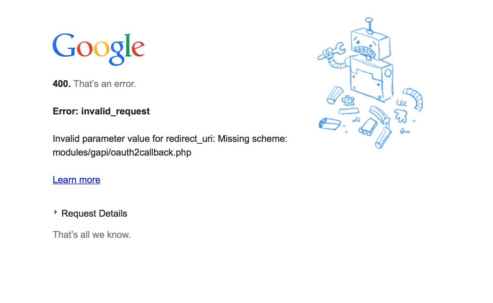

Hi guys,
I have looked through the forum and can only really find 1 post with the same problem but its has had no replies. SO im starting a new threat to hopefully get some attention to it.
I have loaded and put in my Google Analytics code (the UA-65xxxxxx code) into the module as normal. All seems to work fine there. However when I go to the Google Analytics API v1.1.0 Module and try and load in my credentials I get the following error.
400. That’s an error.
Error: invalid_request
Invalid parameter value for redirect_uri: Missing scheme: modules/gapi/oauth2callback.php
Learn more
Request Details
  • scope=https://www.googleapis.com/auth/analytics.readonly
  • response_type=code
  • access_type=offline
  • redirect_uri=modules/gapi/oauth2callback.php
  • approval_prompt=force
  • state=1-e9f5f745e933668baadd02a2fefae061
  • client_id=300039335954-tr0pli7nb88ir979a2ne3brbnp6sr3af.apps.googleusercontent.com
That’s all we know.
I have tried just about everthing I could find on the little posts I could find.
Any help or suggestions would be much appreciated.

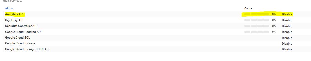

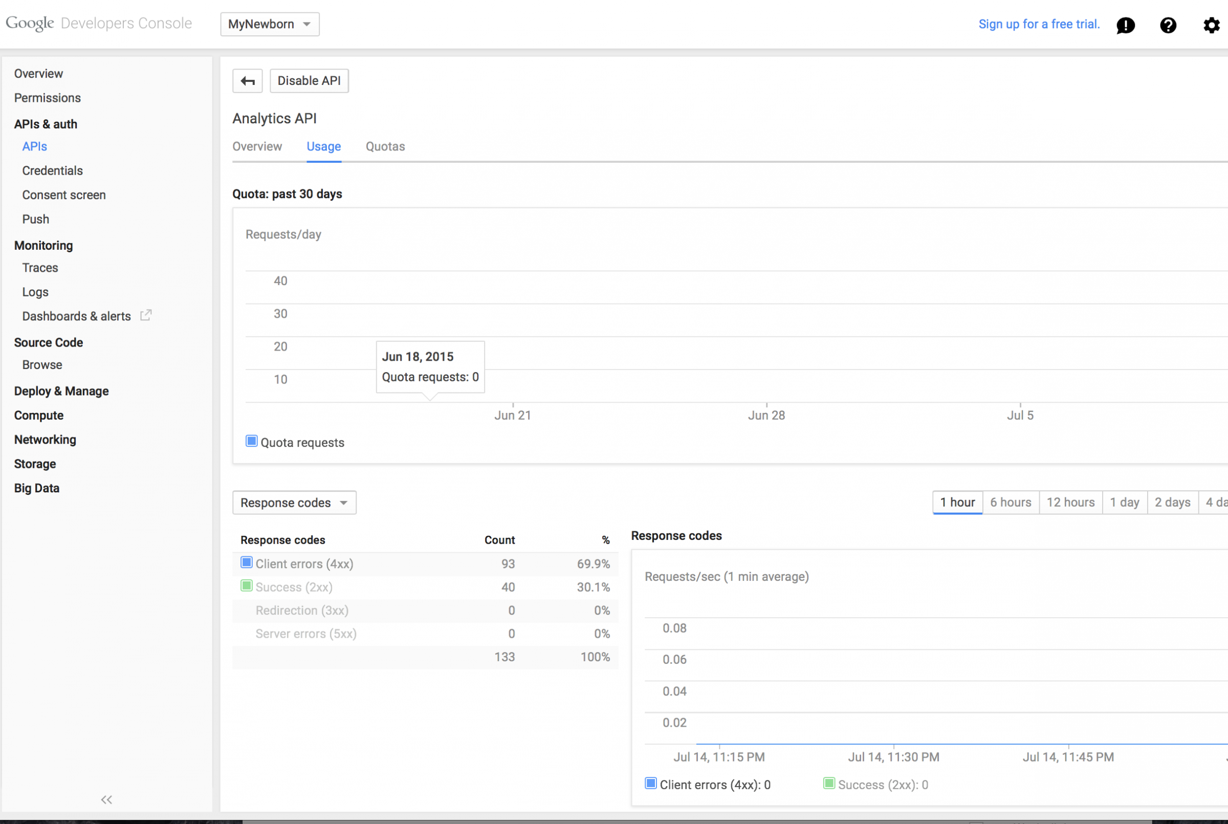

Is it this problem you get (see attachment).
If it's, I think it is after you pressed the button 'no tests received' into PS backoffice>modules>Google API
Well after you get the error, just go to the previous page on your internet browser and normally you will get a green button with example: "yesterday your shop received 100 visitors for a total of...".
If not, you need to Enable your API into Google developers.
Edited by mynewborn (see edit history)

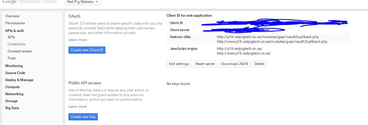

Hi mynewborn,
Thats exactly where I did mine. How ever when I go to the screen (like in your attachment) No requests or anything are there. I have loaded everything as per the instructions with and with out www. Still when I add the credential details to the Google API module I get that error.
So gone through it all step by step and reloaded and refreshed everything. Does somebody know where I could download that module again. (the ones in the store are all paide modules) Maybe deleting the module and re-installing it will help. The only thing I can think of now is that the module has an issue.

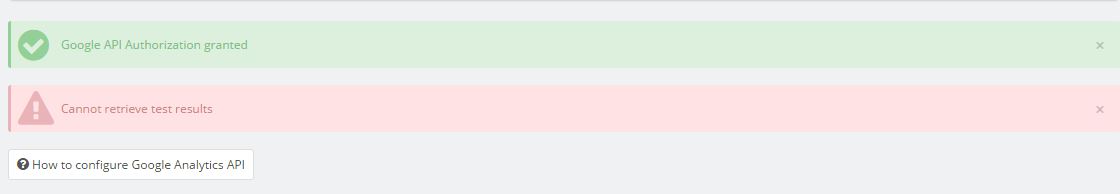

Hi navodyc4
Thanks so much for the reply. I have tried your suggestion.
It finally seems to be doing somthing at least. It now asked me for permission which I granted. However when its done I get the following messages.
Google API Authorization granted but access token cannot be retrieved and Cannot retrieve test results.
Thanks navodyc4 It finally feels like IM getting somewhere. Do you perhaps know why I would be getting those 2 errors above?
UPDATE:
I have tried to submit the details a few times now and get a mixture of the above 2 errors and Google is unreachable (check your firewall).
Final UPDATE:
After re-submitting about 10 times it finally took and everything is working.
THANK YOU SO MUCH navodyc4 and to all who tried to help. This has been bugging me for WEEKS.
Edited by RedPig (see edit history)

I had the same problems.
Regarding those 2 errors in backoffice, go to your modules and check Google Analytics API because after that fixing it came again like "Install". I clicked on it, and it was written that it is already installed but errors disappeared.
Then regarding "Cannot retrieve test results" and this error:
Error: redirect_uri_mismatch
Application: TPV Analytics API
The redirect URI in the request: http:/..... /modules/gapi/oauth2callback.php did not match a registered redirect URI...
I have found that google sometimes cannot read "www" and really this worked for me:
1) In Developers Console - Consent Screen in Homepage URL - remove "www"   so it will stay only   http://domain.com  and
2) in Developers Console - Credentials - Cliend ID - Authorized Javascript Origins
               http://www.domain.com
               http://domain.com
3)              and in Authorized redirect URI
              http://www.domain.com/modules/gapi/oauth2callback.php

I got a bit further, i found out the during the credential test, the gapi modules decode every "&" in the url to "amp;" but the url ends up corrupted ...
like "https://accounts.google.com/o/oauth2/auth?response_type=code&client_id=..." but it should be:
So after deleting all "amp;" and just hitting enter, i got the google page to grant access, but now i get the Error in the module saying:
"Google API Authorization granted but access token cannot be retrieved"
and
