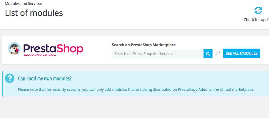

Frederikus Posted October 20, 2015 Share Posted October 20, 2015 I have the same issue I'm using prestashop cloud how can I downgrade? Link to comment Share on other sites More sharing options...
