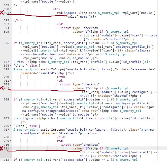

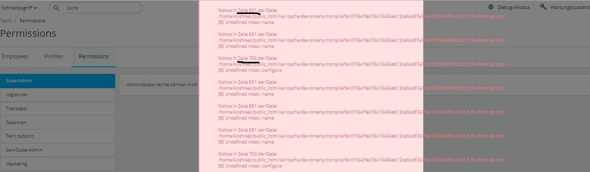

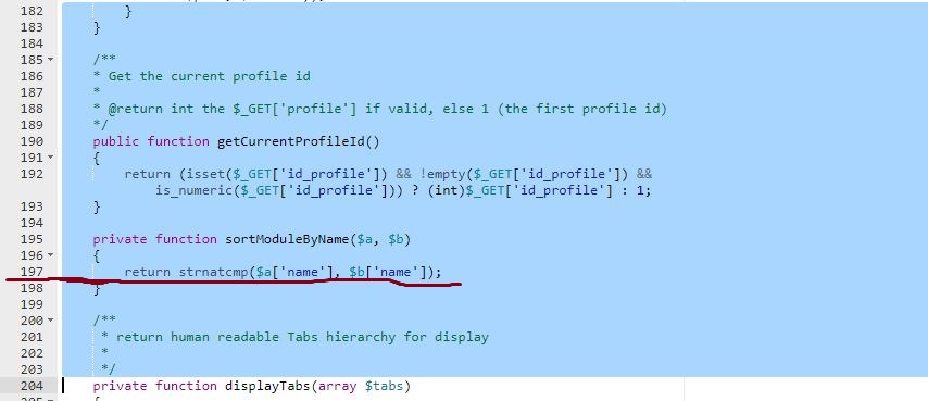

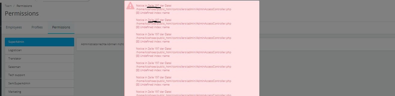

"You are not authorized to configure a module" error
If click on my modules to configure it I get this error - You are not authorized to configure a module, even though I am logged in as superadmin.
This issue started after I removed my ps-access table and replaced it with a clean ps-access DB as I had problem accessing my orders and stats menu. This action solved the issue I had with orders and stats menu, however, it caused issues to configure my modules.
The Issues from controller folder admin_access and var folder cache_dev_smarty_compile. In the image below are more details and location of the errors
Please if you have explanations for the issues please do help!

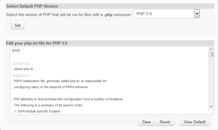

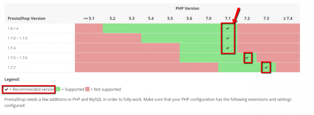

If your Prestashop 1.6.1.23 is clean istallation and problem with module exist from start, please make one test and change your php settings from 7.2. to 5.6 or lower and then go to modules page on Prestashop. Please write here what is happened, can you reach the modules or not.
It is possible that some of modules isn't write for use on php 7.2.15 this mean you need to downgrade your php settings.
I had a case with the AfterPay Module. After insttalation Afterpay module Prestashop reported error when I try to reach modules page. After I changed php settings all works well.

18 hours ago, katicziv said:
2020-03-04_1237
For PHP 7.3 you need to have Prestashop 1.7.7
If your Prestashop is not latest version you need to decrease your PHP according to your prestashop version

Before you install compatible version of Prestashop with your PHP version on server you need to this:
https://devdocs.prestashop.com/1.7/basics/installation/system-requirements/
Also you can use documentation for each version of prestashop from here
http://doc.prestashop.com/
Latest version is located for download here: https://www.prestashop.com/en/download?ab=1

On your cPanel of your server you have PHP settings like this
You need to turn ON extensions that is needed for Prestashop (read about it on previous post link)
2020-03-05_1002
and then press "Switch to PHP options" and set what is needed for prestashop (read about it on previous post link)
2020-03-05_1006
There is a way to do this, send email to technical support and ask them what you need to change:
PHP version
to turn ON PHP extension (make a list)
to set PHP options (make a list)
If they cannot do this consider to change your host provider
