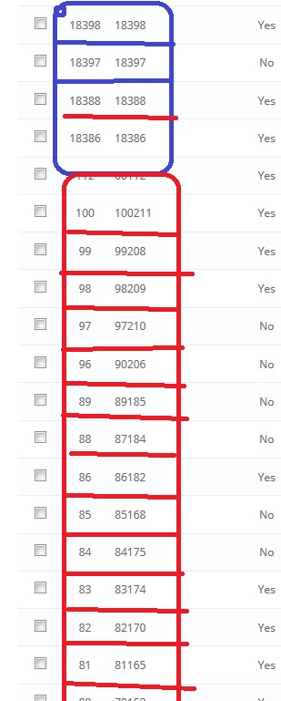

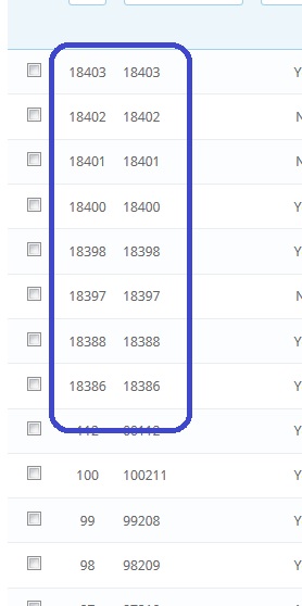

I had trouble with that module, see picture, marked by red.
the method above, marked by blue.
I went to prestashop after ZenCart, and had orders 18k
not  consecutive numbers because I just made this change and we wiped the test orders
Edited by benyben (see edit history)
  • Like 1
