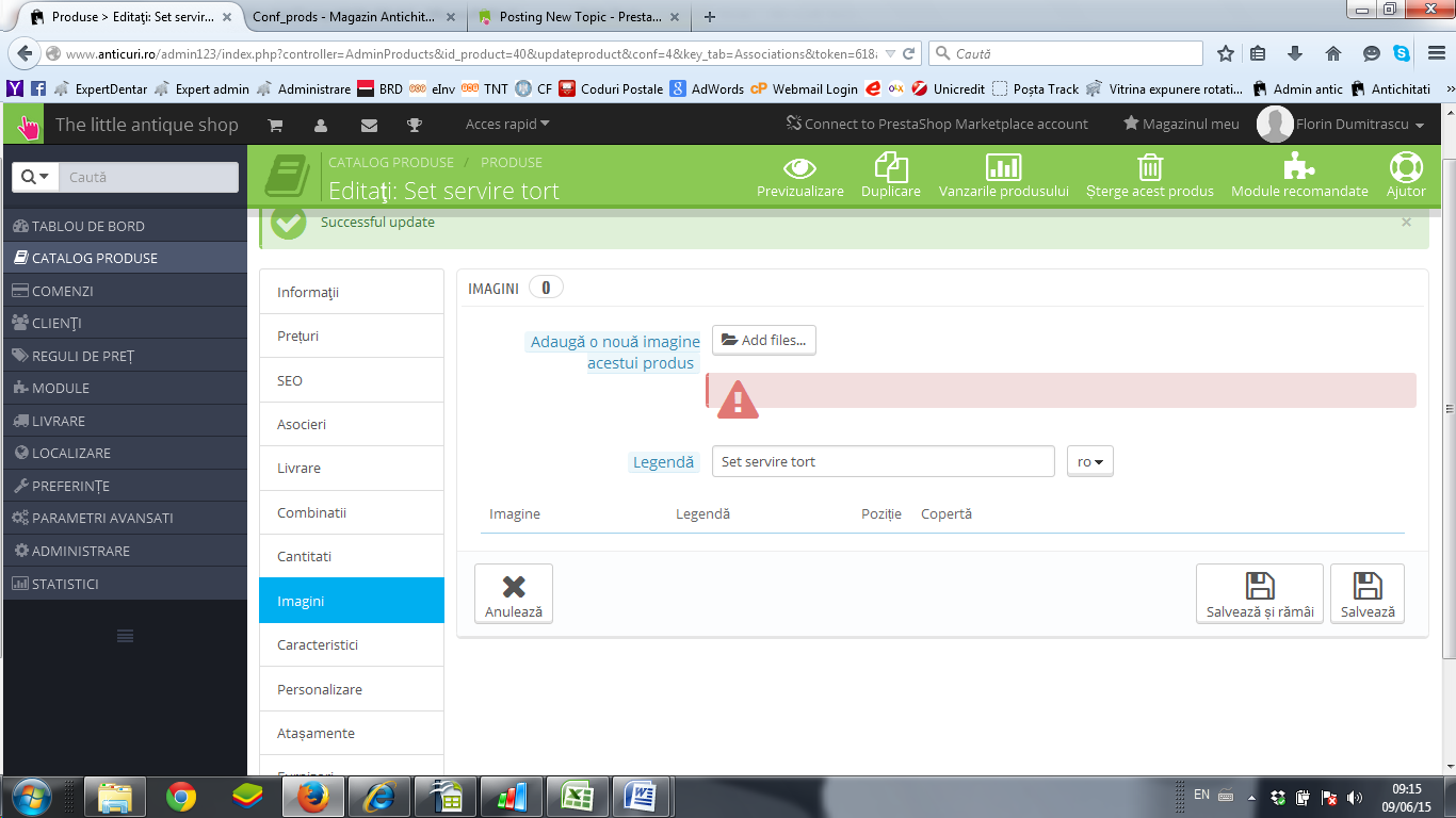

florilos Posted June 9, 2015 Share Posted June 9, 2015 Salut, mi-a aparut o problema cand incarc fotografii la produs. Ma poate ajuta cineva? Multumesc anticipat. Link to comment Share on other sites More sharing options...
costi43 Posted June 9, 2015 Share Posted June 9, 2015 Vezi sa folosesti extenzia .jpg dac nu ai activat si .png ul, sa nu depaseasca doi megam Link to comment Share on other sites More sharing options...

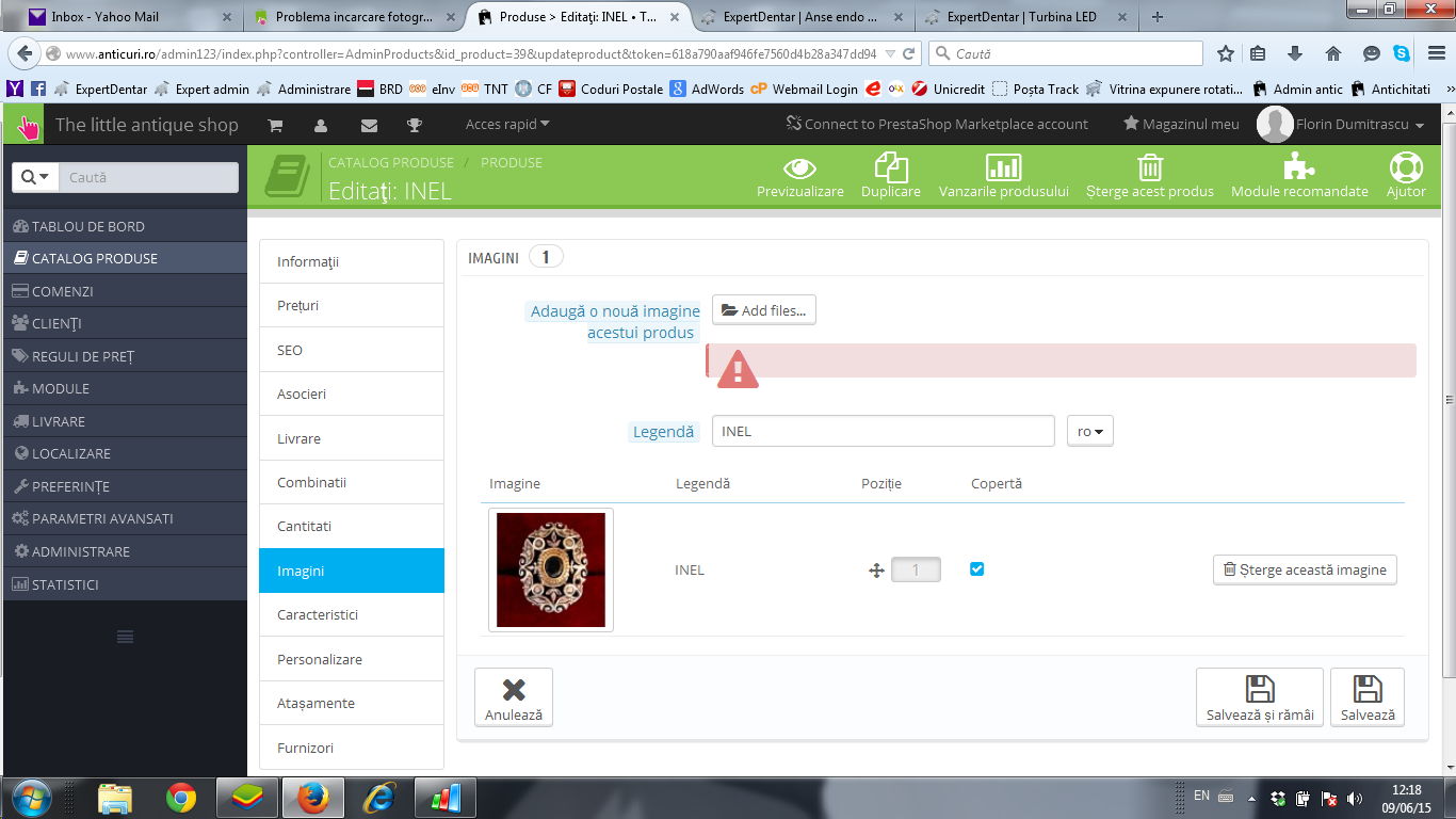

florilos Posted June 9, 2015 Author Share Posted June 9, 2015 Atasez un prtsc dinainte de a atasa pozele, se vede ca sunt jpg si ca sunt sub 1M. Link to comment Share on other sites More sharing options...
