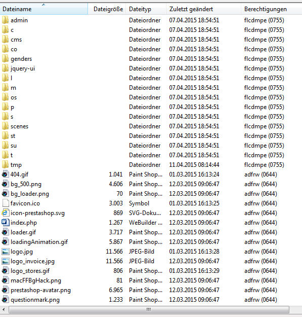

Prestashop don't create new folders. The folder /img is a native folder and it contains by default 16 subfolders and 14 files (see screen attached).
If you install new modules, so the module creates his own /img folder at /modules/newmoduleinstalled/img. Here perhaps when you add images it could be possible that the module adds a new sub-folder.
But this does not apply to the native /img folder on which you will find all images for products, cms, for suppliers, etc...

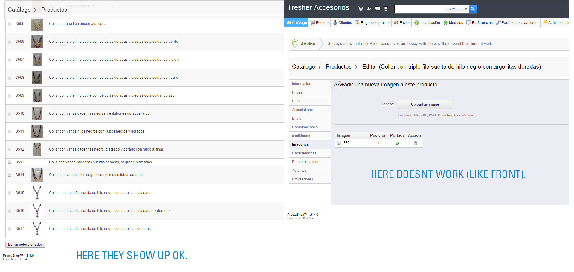

See attached from admin! At products list, shows up. But inside the product, it brokes..like front.

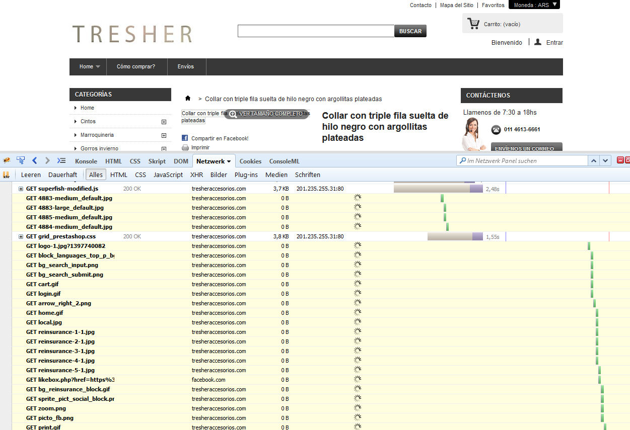

You should regenerate your product images. They are really broken. They are available, but empty with 0KB. See screen attached.
If there is a CHMOD problem (access denied) so you will have error 403 on the console, but I have no code and 0KB, which is a problem of the picture and not with writing/reading rights.
How to regenerate pictures: TAB "preferences -> images -> regenerate images -> products -> all, remain rest setting (only change to NO, when server does not complete the reindexation process).
If the regeneration does not help, you should contact your provider, perhaps there are some restrictions on your host concerning traffic or webspace size.
