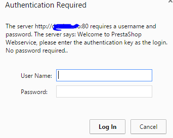

I have prestashop 1.5 installed on my server, and currently have 1 API Token for testing.
Whenever i try to access it via http://myshopdomain.com/api/ it keep asking for a username + password with a message "Authentication Required" (see attachment)
But when i try to access it directly via: http://myshopdomain.com/api/?ws_key=XXXXX it displays all available endpoints.
I already set the "Active mode CGI for PHP" to TRUE I have a feeling that this has got to do with my .htaccess, but i am not sure what to do with it. Can anyone please help me

Hello, to access yourwebsite.com/api you only need to register as a user the password generated from Advanced Parameters -> webservice.
If you can not access in this way, activate the CGI mode for PHP from Advanced parameters -> webservice
If you still can not connect, you can pass as a parameter to the url yourwebsite.com/api?ws_key=YOURKEY and you can connect.
Regards!

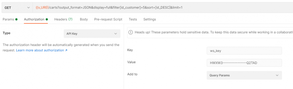

It look like feature, not a problem.
All works, if you put ws_key into query. No other authorization way forks for now. From my point of view it is worse then basic auth, but what to do?!
All works fine, if there is &ws_key=KEY at the end of reuquest.
In Postman like this:
