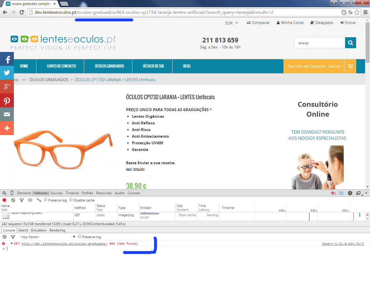

Another problem I'm seeing on your site is the change URL-architecture. You eliminated the ID from category, no it is running several 404 errors. Take a look with Chrome developer tool (F12). Network -> add a search name and open one of the products.
The change of the architecture could be indeed a problem for not finding products correctly and showing wrong results.
Correct URL achritecture: dev.lentesoculos.pt/4-oculos-graudados/463-oculos-cpp173-d-laranja.... (4 is an example only!!)
YOUR URL architecture: dev.lentesoculos.pt/oculos-graudados/463-oculos-cpp173-d-laranja.... here the ID of category is missing and driving to several errors.
You should inspect also the error_logs or your server from time to time !

I suggest you to undo all your core changes, especially the one omitting the category-ID's on URL, switch to default template, test the search engine if it is working without any problems, and than switch to your bought theme. Only by this way you can locate the problem.
Omit ID's does not take any SEO effects besides it drives to problems, cause Prestashop needs these ID's for to work.

Hi. I tried erouvier29's patch and it now finds missing products, but it doesn`t show products at all. It just tells - "Found xx products"
Check attached picture
Edit: forgot to mention, im on 1.6.011, have 3 languages (only 2 are used in front office (latvian and russian), 3rd is english that is kept because not everything is properly translated in our language for backoffice and sometimes I need to switch from latvian to english) that were set up at the creation of shop. Our prestashop version history is 1.4.8->1.4.9->1.6.011
Edited by mareksmareks (see edit history)
