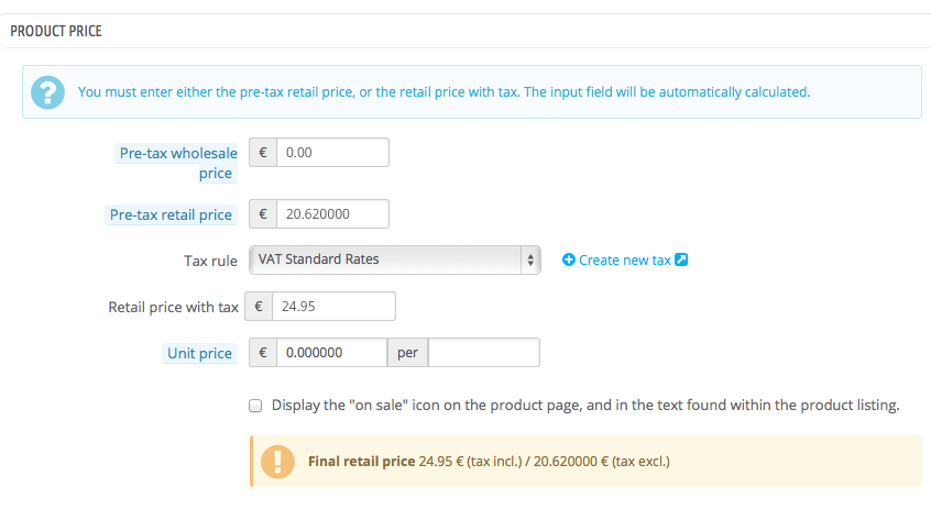

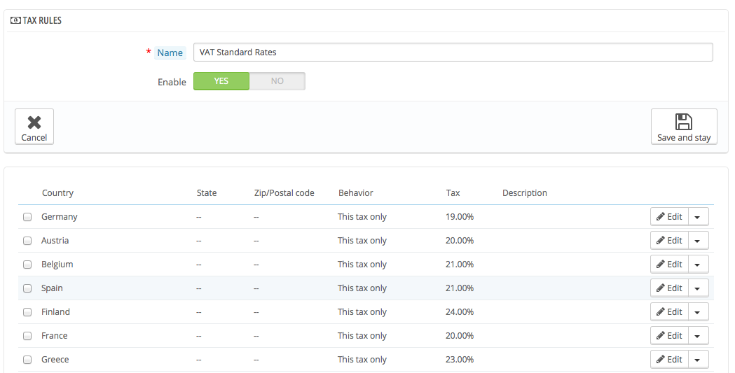

frankpulido Posted January 10, 2016 Author Share Posted January 10, 2016 Hi there, I have solved it long ago but given that no-one had shown interest I didn't wrote the solution. It was a configuration problem, you don't need to install any module. 1. I created a single "tax rule" that I named "VAT standard rates" (Go to LOCALIZATION/TAX RULES) 2. Within the rule "VAT standard rates" I added a RULE for each Country where I have delivery enabled Spain : 21% Germany : 19% France : 20% (and so on…) SEE SCREEN SHOT ATTACHED 3. For each product : Go to CATALOG/PRICES and choose the "tax rule" that applies which in my case I named "VAT standard rates" SEE SCREEN SHOT ATTACHED If you plan to install a module, I suggest you install a module for massive changes, so it would help you to choose the TAX RULE for all your catalogue, as well as any other massive changes you may need. 2 Link to comment Share on other sites More sharing options...

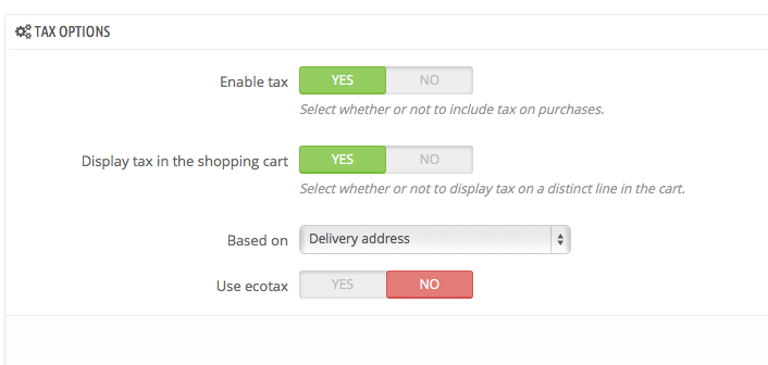

frankpulido Posted January 10, 2016 Author Share Posted January 10, 2016 Ah, and don't forget to indicate that sales must be taxed according to "delivery address" : Go to LOCALIZATION/TAXES, scroll down and SET : TAX OPTIONS / BASED ON : Delivery Address SEE SCREEN SHOT ATTACHED 1 Link to comment Share on other sites More sharing options...
