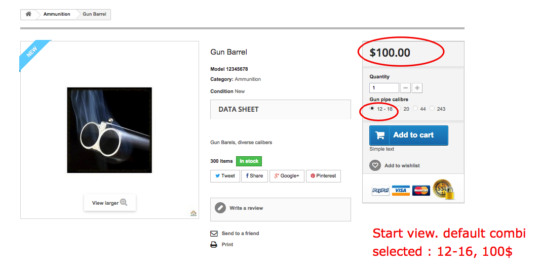

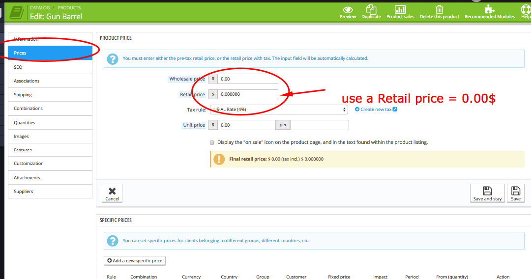

Ha, can just very simple, we don't need the extra attribute:

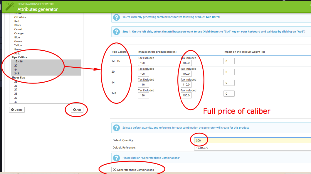

Create new product.
Set retail price to 0.00$              <-- this is the important step!
go to combinations and generate combinations with the combinations generator:
- Select the calibers you need, click ADD
- add the FULL PRICE of each caliber in the price impact field     <-- No calculation needed!
- add some quantity if you wish
- Press 'generate'
(If needed, change the default combination)
save all changes
If you then go to the shop:

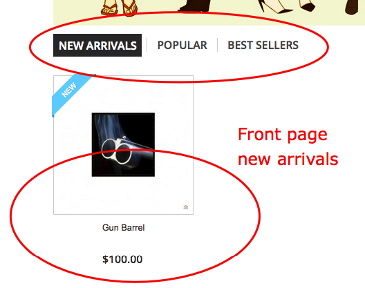

On front page, the new product is shown (on New Products for example, with the default combination price shown (12-16 = 100$)

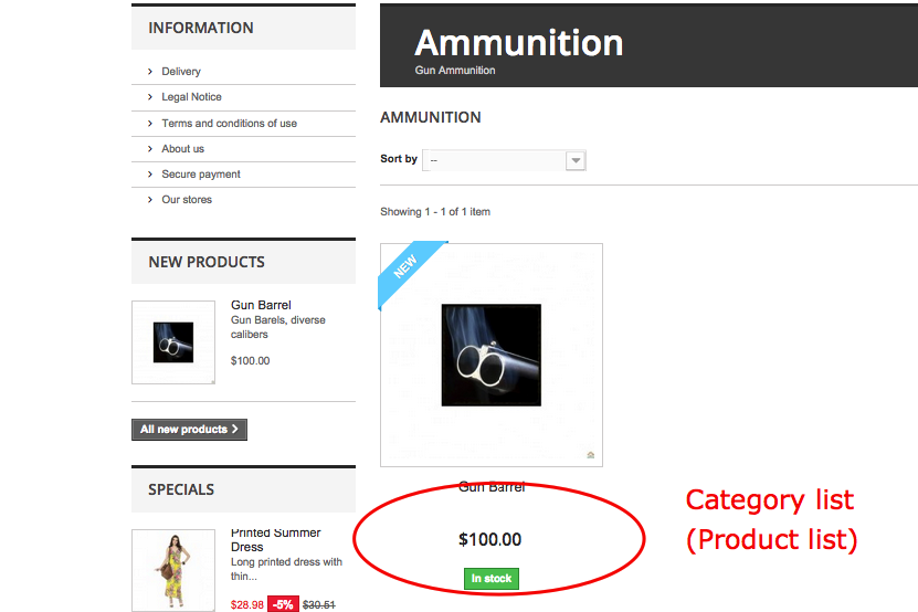

If you go to the category list (product list), you also see the price of the default combination mentioned:

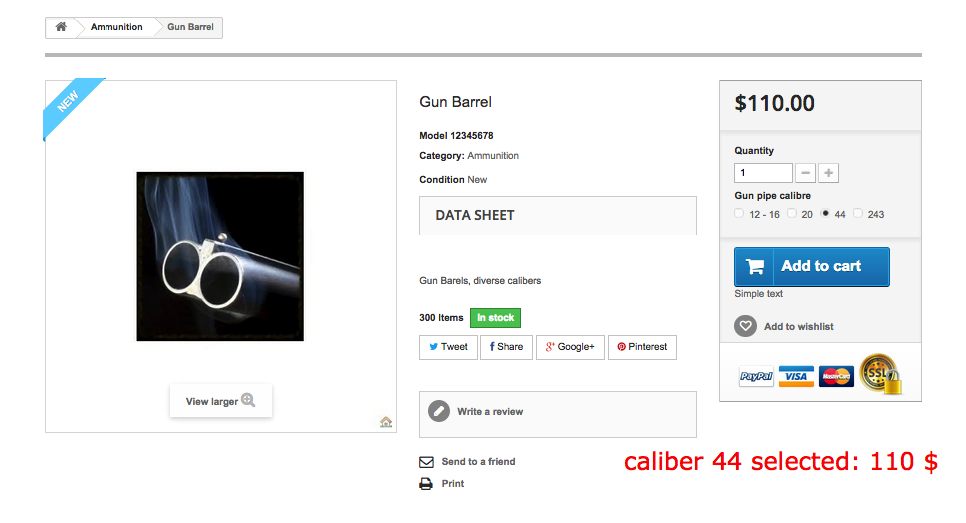

Then when you go to the product detail page, you again see the default combination selected (12-16), with its price 100$
You also see all attributes to choose from, when you change to for example 44, it will again show the full price of that caliber (as it always did): 110$
So, summarised:
The trick is to keep the retail price at 0.00. Then you don't have to calculate the increase (i.e. the difference between the 'default' combination ad the other combination's price), but you just add the FULL price as combination price, no calculation needed.
Hope that is what you needed,
pascal.
