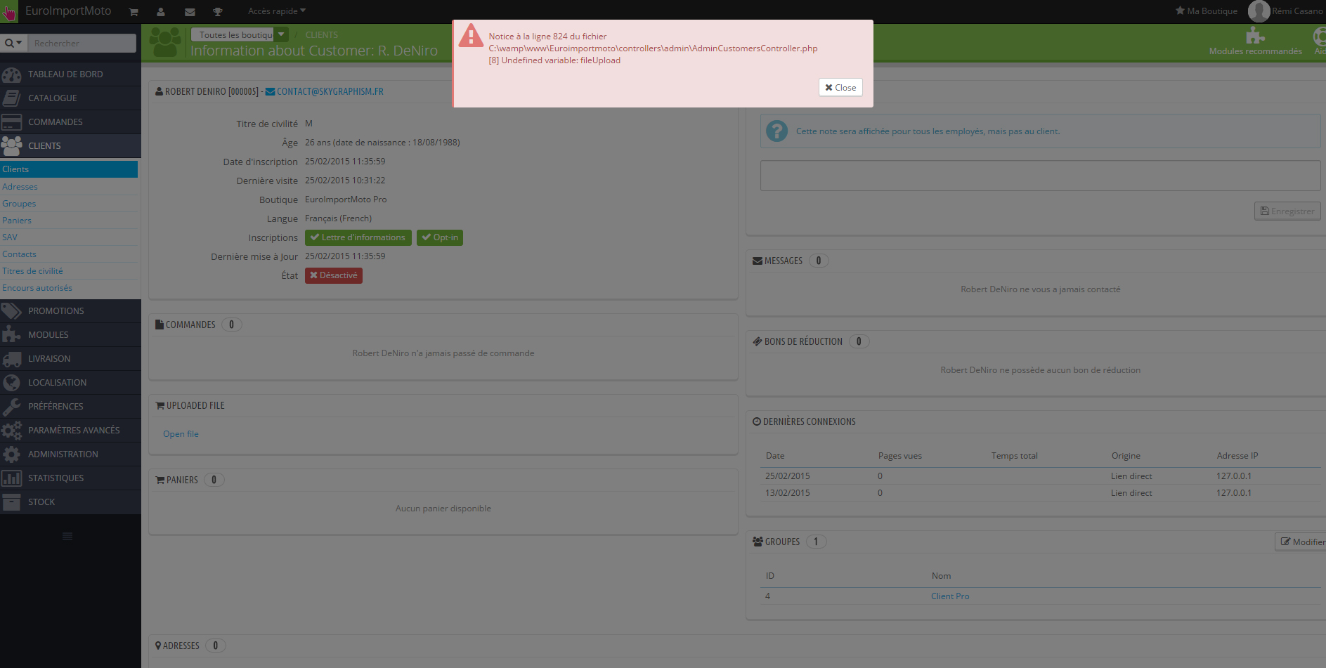

But I still have the message error, it seems to be not very important because all work but I'm just curious to understand why this error is detected.....
I join a printscreen of this message .
The line where there is the bug is :
'fileUpload' => $fileUpload,
(if nobody have any answer don't worry it doesn't really matter because all the rest work :)  )

To show the filename in the client list open ./controllers/admin/AdminCustomersController.php around line ~159 and add:

In the same file, around ~821:
// Connections
'connections' => $connections,
// Uploaded File
// Referrers
'referrers' => $referrers,
'show_toolbar' => true
Remember to clean the cache of Prestashop after uploading the modified files. I was based on the lastest PrestaShop 1.6.0.11.
If you want to show the files inside the Customer View you need to modify ./admin/themes/default/template/controllers/customers/helpers/view/view.tpl
