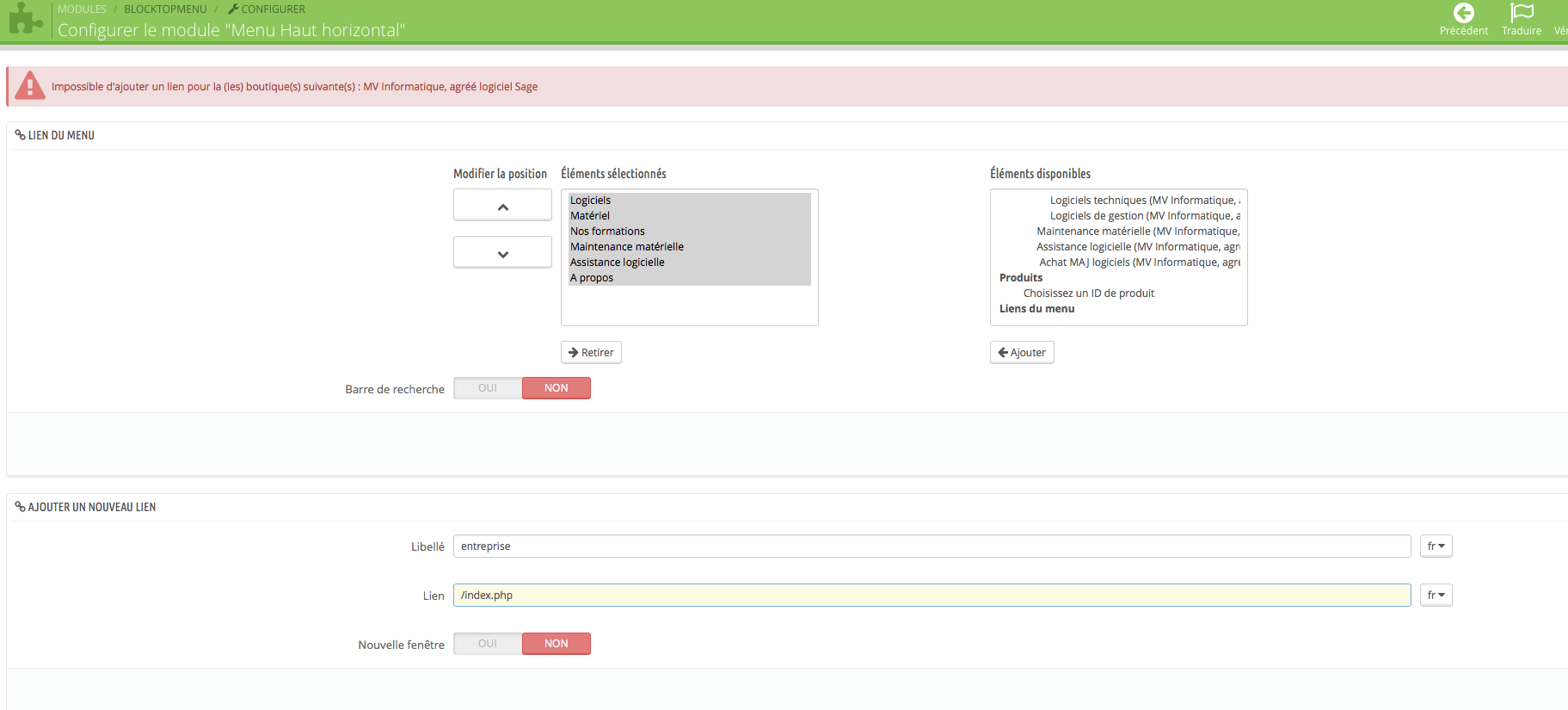

lam560 Posted January 12, 2015 Author Share Posted January 12, 2015 Here is a screenshot of the error. Thanks Link to comment Share on other sites More sharing options...
NemoPS Posted January 12, 2015 Share Posted January 12, 2015 It appears the linksmenutop_lang doesn't have the link field. You can 1. reset the module and see if it helps, but it will likely wipe off your module's config and structure, so you'll have to rebuild it 2. add it manually to that table of the db (I think it's a text or varchar entry 1 Link to comment Share on other sites More sharing options...
vekia Posted January 12, 2015 Share Posted January 12, 2015 hello label and link field are a part of ps_linksmenutop_lang table specification of fields below: if Nemo suggestion about "reset" module will not work, follow this: add these fields with software to manage database like phpmyadmin then click on "go" and at the end fill out form with field name, field type and length Link to comment Share on other sites More sharing options...
lam560 Posted January 12, 2015 Author Share Posted January 12, 2015 (edited) Work now with the reset. I check the database after the reset and the missing fiels were created. thanks Edited January 12, 2015 by lam560 (see edit history) Link to comment Share on other sites More sharing options...
