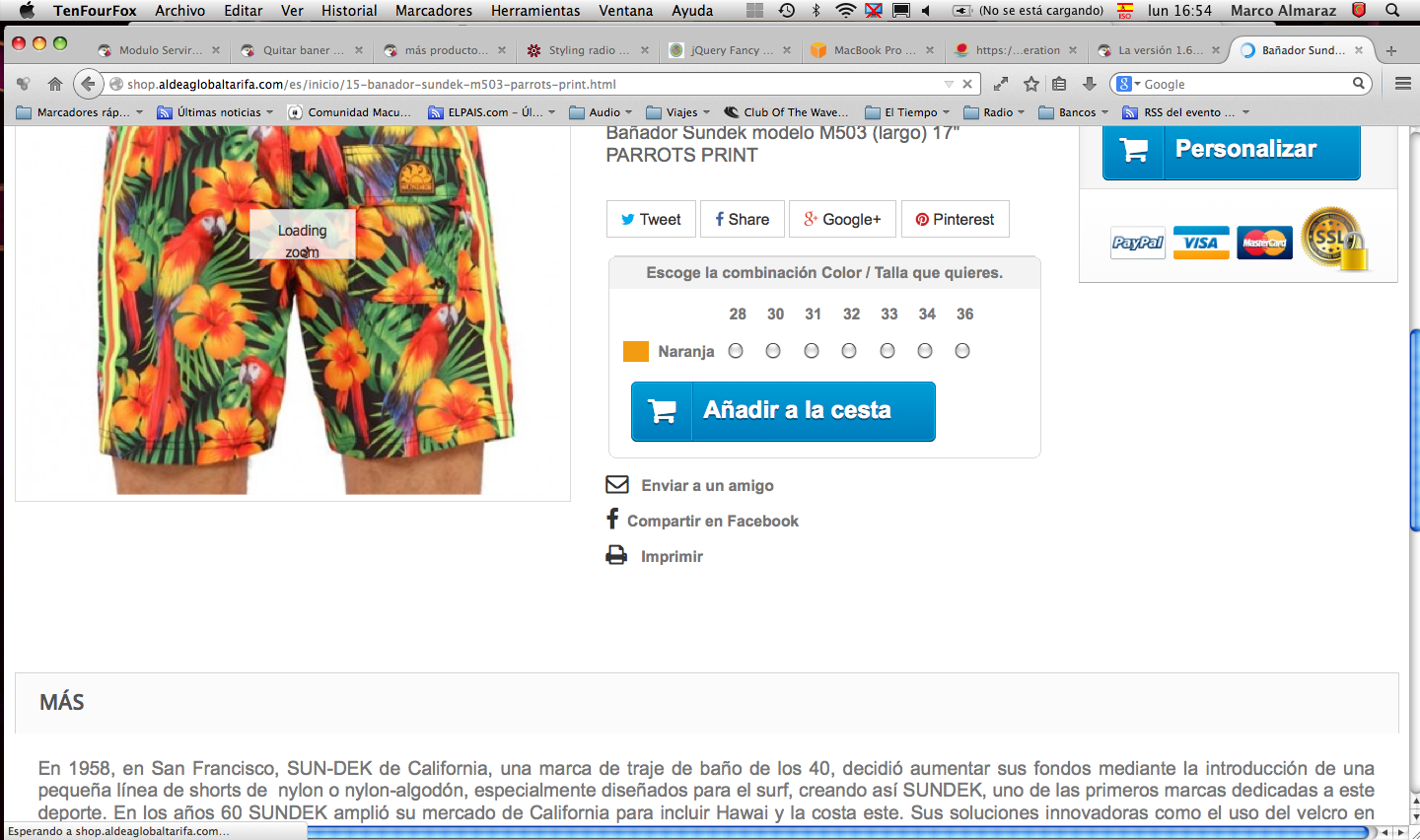

Can any body help?

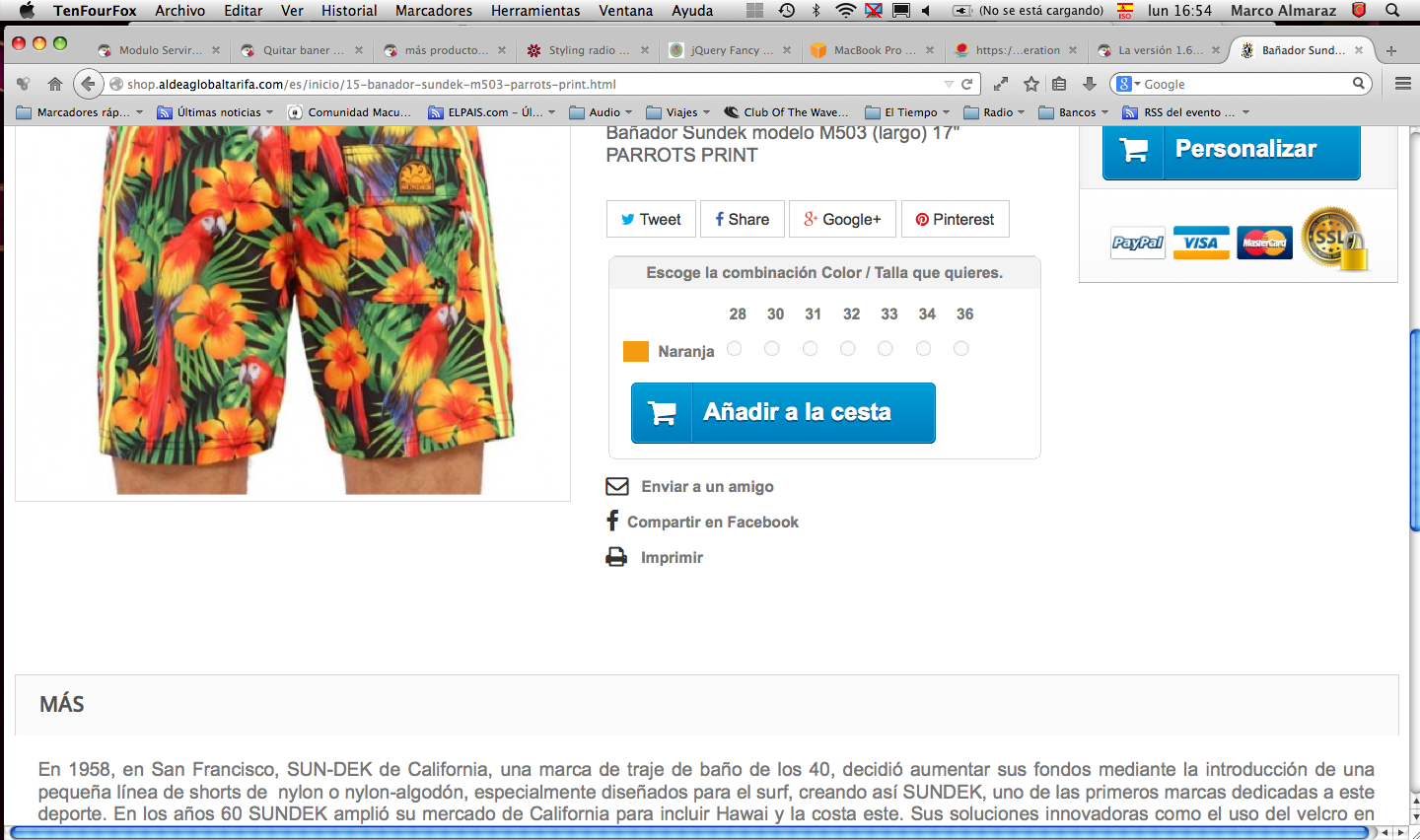

This is the problem that I have. When the page loads, for a second, radio buttons are as they should be, and then disappear as seen in the image, to be almost invisible not easy to see if it needs to be selected.
I'm using Presto-Changeo Attribute Grid. The error occurs with this module "on" or "off", so it's not the module.

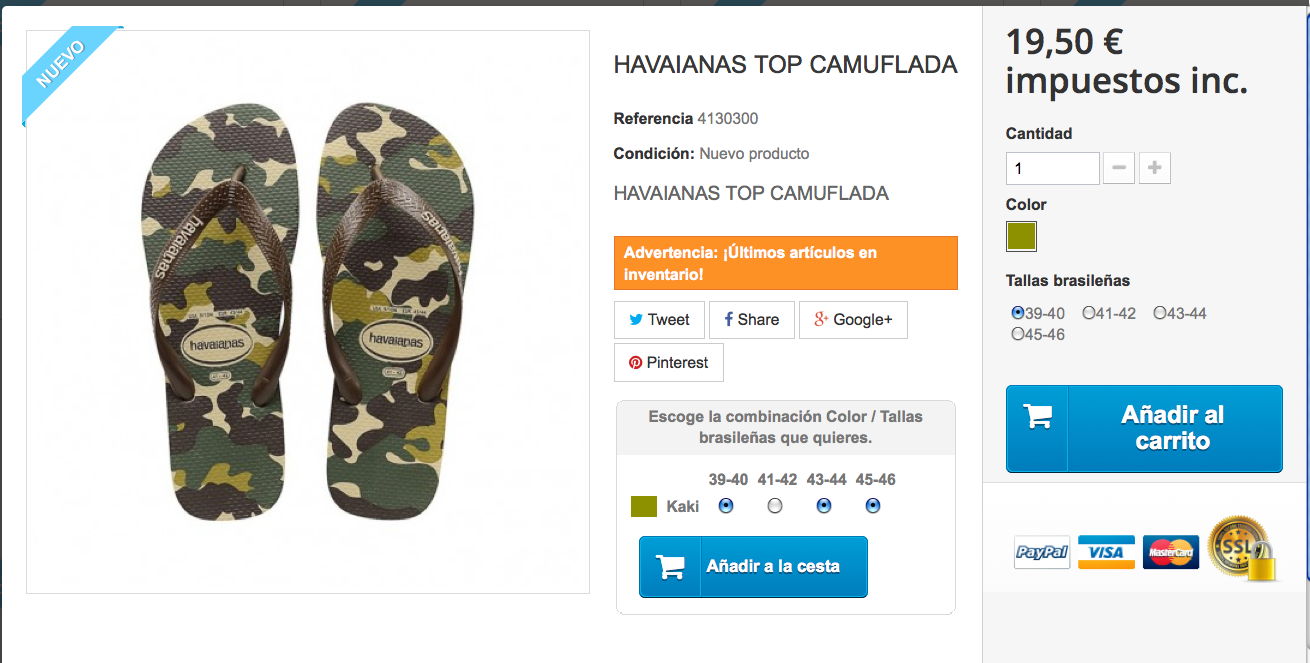

In the following Product, it happens that, if I delete the file 15-jquery.uniform-modified.js in the themes/default-bootstrap/js/autoload, radio buttons look as they should, but in duplicate if Attribute Grid is active, and when a combination is selected, it does not deselect the previously selected.
I think we should correct a line in that file, 15-jquery.uniform-modified.js but I do not know which line.
