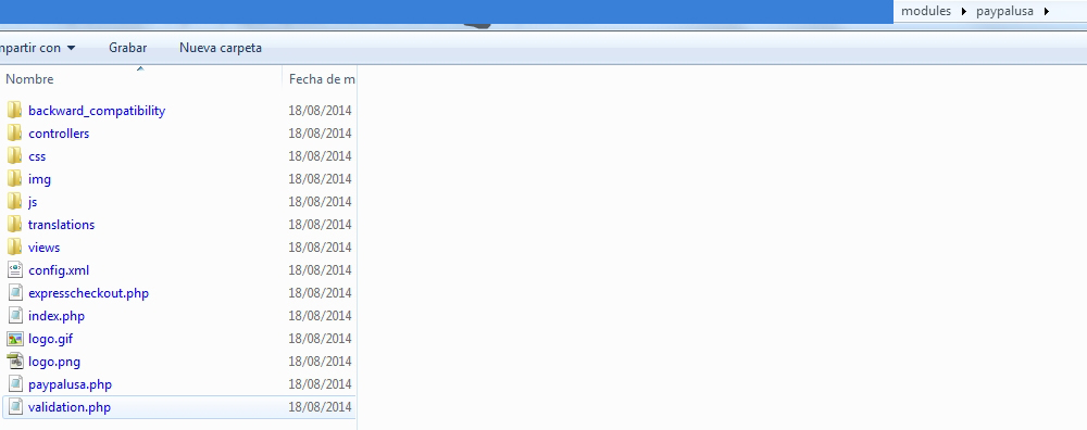

So if I place this code:
@curl_setopt($ch, CURLOPT_SSLVERSION, 1);
@curl_setopt($ch, CURLOPT_SSL_CIPHER_LIST, 'TLSv1');
In the space of the code bellow, I fix the problem?::
curl_setopt($ch, CURLOPT_VERBOSE, 0);
curl_setopt($ch, CURLOPT_SSL_VERIFYPEER, false);
curl_setopt($ch, CURLOPT_SSL_VERIFYHOST, false);
curl_setopt($ch, CURLOPT_RETURNTRANSFER, true);
curl_setopt($ch, CURLOPT_POST, true);
curl_setopt($ch, CURLOPT_POSTFIELDS, 'PARTNER='.urlencode(Configuration::get('PAYPAL_USA_MANAGER_PARTNER')).'&VENDOR='.urlencode
Edited by Anthony DeLa Riviere (see edit history)

I'm kind of lost here.  I am using Paypal USA Canada module 1.3.4 (on PS 1.6.0.8) and I can't find the API folder everyone is referring to. (There is no such folder in the module)  I received an email directly from Paypal informing me that my shop WILL BE affected on December 3rd.  Yet I can't find anywhere a fix for my module.
I prefer NOT to upgrade my module because everytime I did in the past, it was a total mess.
Please help !!!
Carly
The following code is the closest to the one everyone is talking about and it's located in my Paypal.php file.  Can anyone let me know what I should be changing or adding ?  I also saw this code in other files in the module - should I be changing those as well?
Thanks in advance
$ch = curl_init();
  curl_setopt($ch, CURLOPT_URL, 'https://api-3t..(Configuration::get(PAYPAL_USA_SANDBOX') ? 'sandbox.' : '').'paypal.com/nvp');
  curl_setopt($ch, CURLOPT_POSTFIELDS, 'METHOD='.urlencode($method_name).'&VERSION=98&PWD='.urlencode(Configuration::get('PAYPAL_USA_API_PASSWORD')).'&USER='.urlencode(Configuration::get('PAYPAL_USA_API_USERNAME')).'&SIGNATURE='.urlencode(Configuration::get('PAYPAL_USA_API_SIGNATURE')).$params.'&BUTTONSOURCE=PrestashopUS_Cart');
  $response = curl_exec($ch);
  curl_close($ch);
Thanks KevinNash for your reply.
The link you are referring to clearly saids that the Paypal USA module hasn't been checked yet.
I don't understand then that Paypal would send me the email to update my connection if there is no issue.  I really think there is.
Unfortunately, it seems to me that because less people use the Paypal USA Canada module (vs. the Europe one), it is less of a priority.  We're 10 days away from the date that the Paypal module might become unusable and it's a critical part of the website.  I find it a little alarming that there is no clear answer.
If anyone has some info - Please help !

Hello,
The PayPal USA module is not impacted by Poodle. All PrestaShop merchants using the PayPal USA module can ignore the alert we issued for the PayPal Europe module.
PayPal USA does not force the use of SSL v3. So whatever your config is, you're good :)

This variation TSL also affects older versions of Prestashop?
In this case what should I change?
Why it is not possible at this time to perform an update module of prestashop 1 .3
Thank you for your help
Your version not uses the sslv3 protocol, no changes required.
Hi,
I'm using 1.4.7.0 with "paypal with fees" modul. Could you check please if i need to change something on paypalconnect.php ?
I can't find those lines to change mentioned here:
http://www.prestashop.com/forums/topic/380185-paypal-modification-ssl-v3-to-tls/
Thanks

i have done the changes below, everything is fine
                        1.2.1 First change
Find the line :
@curl_setopt($ch, CURLOPT_SSLVERSION, 3);
Remove this line or you could choose to replace this line with this new line below :
@curl_setopt($ch,CURLOPT_SSLVERSION, defined(CURL_SSLVERSION_TLSv1) ? CURL_SSLVERSION_TLSv1 : 1);
Edited by meimeisi (see edit history)
