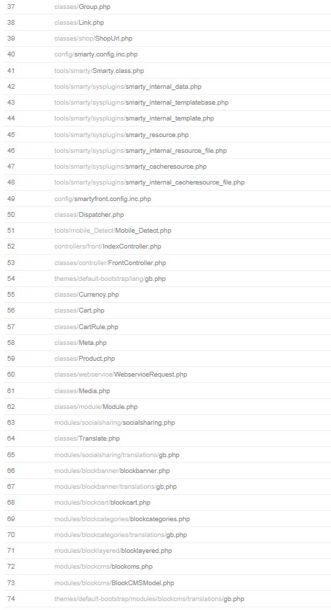

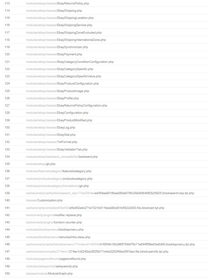

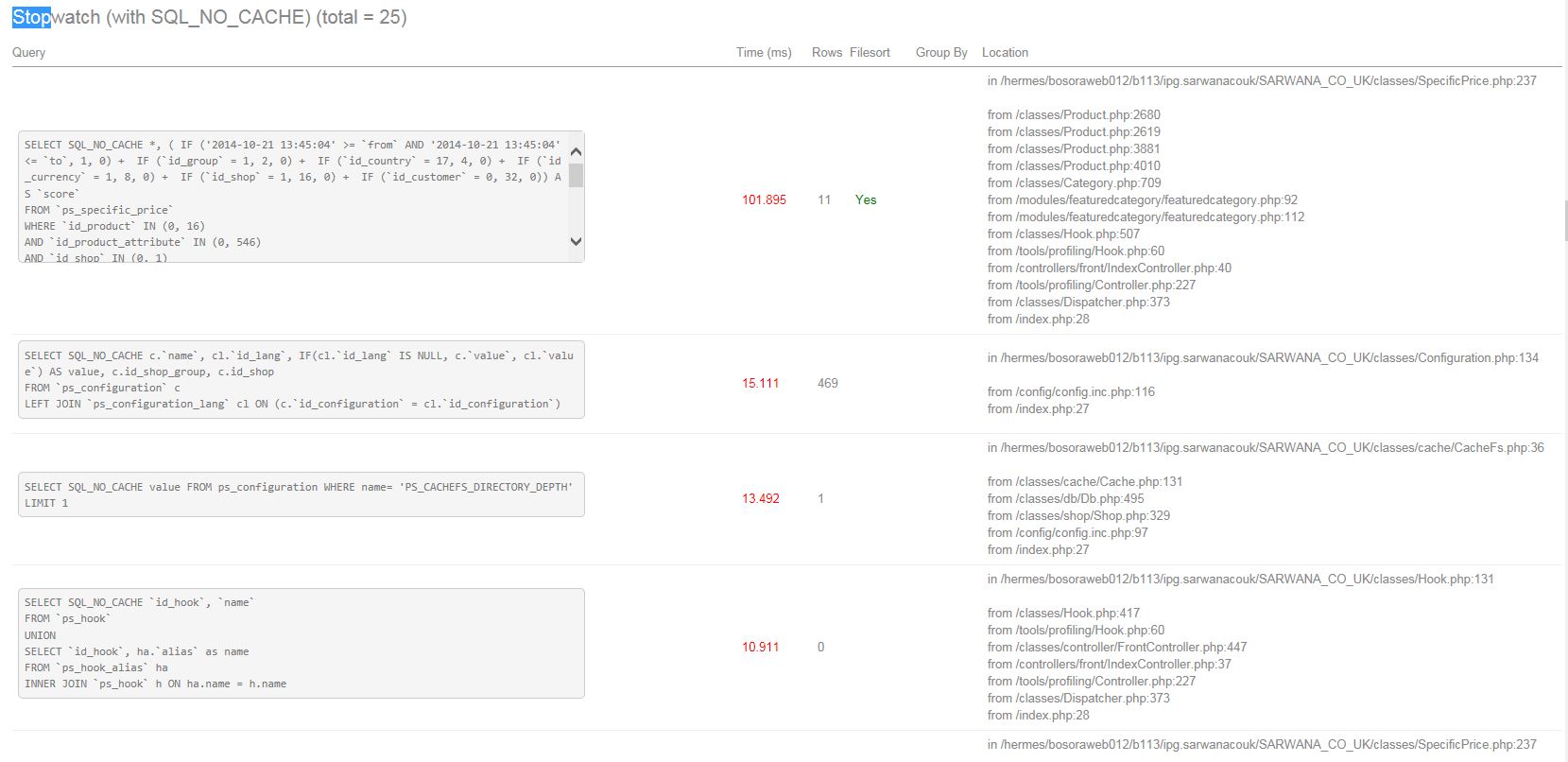

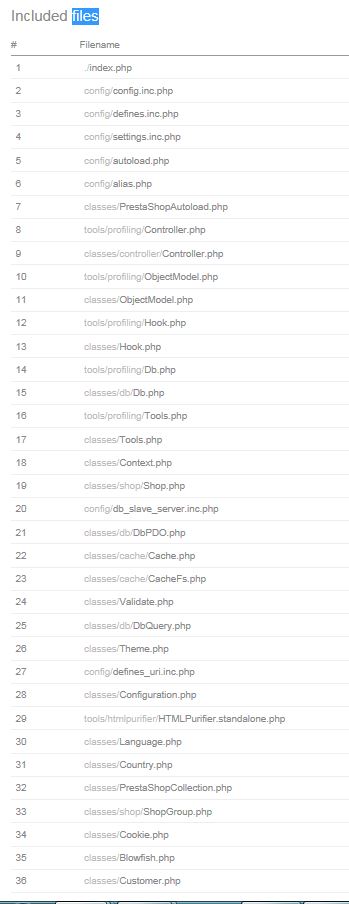

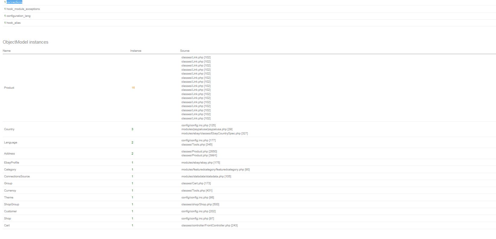

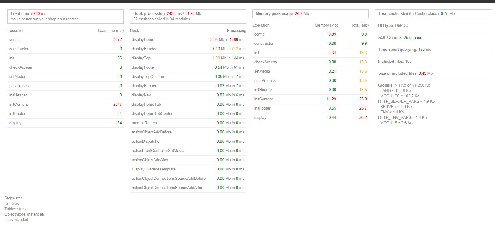

PrestaHeroes USA Posted October 20, 2014 Share Posted October 20, 2014 when anyone has slow shop. follow this to determine where slow 'part' might be. open file config/defines.inc.php set following to true | visit slow page(s) | collect profiling data (scroll down)...analyze. define('_PS_DEBUG_PROFILING_', false); tip: bo-->advanced parms-->performance-->set move java script bottom yes (make sure to test your shop functions)... Link to comment Share on other sites More sharing options...

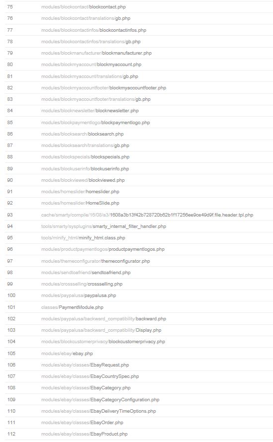

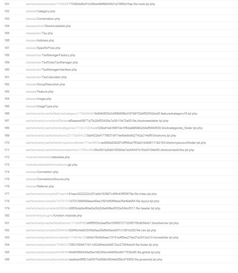

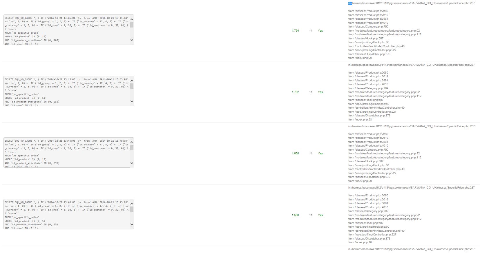

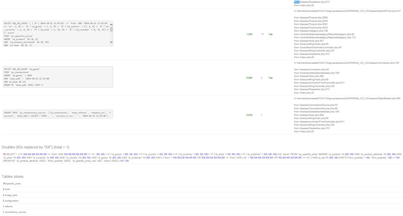

sarwana Posted October 21, 2014 Author Share Posted October 21, 2014 (edited) @El Patron I got the data but I don't understand it. I have attached the file debug.txt Edited October 21, 2014 by sarwana (see edit history) Link to comment Share on other sites More sharing options...
PrestaHeroes USA Posted October 21, 2014 Share Posted October 21, 2014 @El Patron I got the data but I don't understand it. I have attached the file that is really hard to read can you capture, save as a .pdf and attach please? Link to comment Share on other sites More sharing options...
sarwana Posted October 21, 2014 Author Share Posted October 21, 2014 (edited) hi @El Patron I have left the setting on. please see the site Sarwana.co.uk Edited October 21, 2014 by sarwana (see edit history) Link to comment Share on other sites More sharing options...
PrestaHeroes USA Posted October 21, 2014 Share Posted October 21, 2014 if not hosting issue, then we can assume at one point the shop was not this slow, yes? There are a couple of ways of trouble shooting this, typically we try to determine what we may have done to cause slow down, i.e. module. we can go through non-native modules, disable and re-test looking for change. before doing this, try this, turn off all non-native PrestaShop modules and overrides, re-test. If shop speeds up then you can start looking and profiling data first, like featured categories etc. http://screencast.com/t/9MlSlCsx Link to comment Share on other sites More sharing options...
