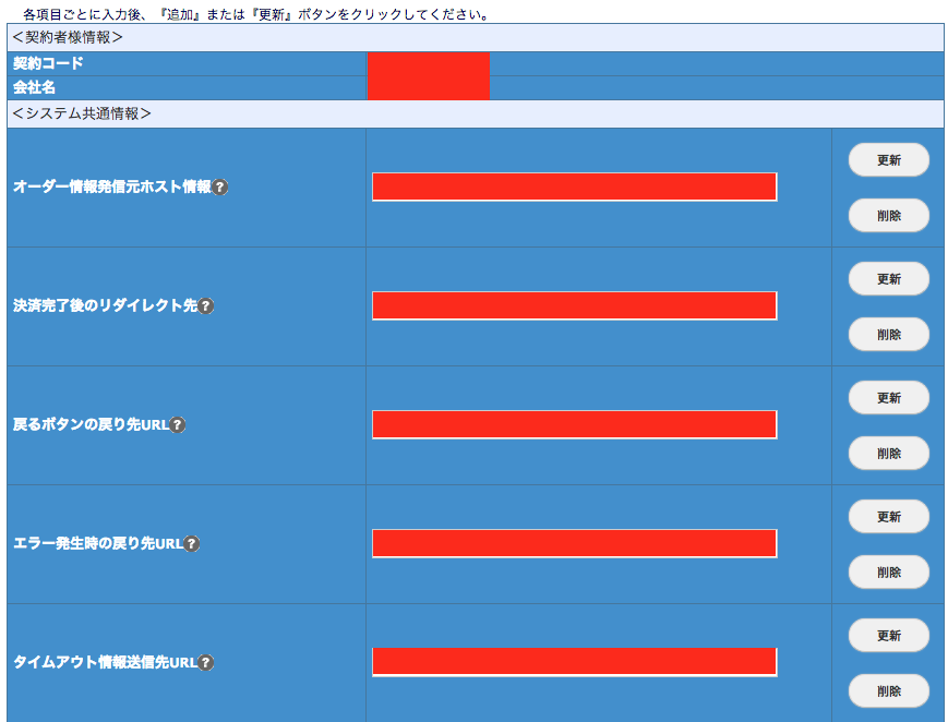

Hello Omine, thank you very much for your response. I'm using PS1.6.1.23, it is now connecting but I am now receiving an error code 908 [ このCGIを実行する権限がありません] and I already inputted the hostnames in "オーダー情報発信元ホスト情報" textbox. Should I put more details on the other boxes? (I have attached a screenshot of EPSILON admin page)

Hello Omine, this has been solved, however upon payment validation I am receiving an error that the epsilon.txt / epsilon.html for order mailing confirmation is missing in the module.
Hi Steve Joms!
Glad to know you solved the first issue.
At the field "オーダー情報発信元ホスト情報" just add the name of your host or the IP address.
All others fields just leave empty. They are not necessary.
The files  epsilon.txt or epsilon.html do not exists and aren't needed.
Example, the fields bellow, leave all empty:
決済完了後のリダイレクト
戻るボタンの戻り先URL
エラー発生時の戻り先URL
タイムアウト情報発送先URL

Thank you for your response Omine.
I just solved also the issue for the order-confirmation mailing with Epsilon payment. I solved it by unchecking the sending of mail for the order-confirmation with Epsilon in order statuses. If that control is checked (which is set as check by default) it will look for epsilon.txt or epsilon.html file for the mailing process but those files aren't exist so it will give an error.
