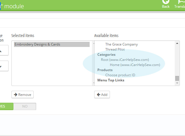

chipslay Posted October 15, 2014 Share Posted October 15, 2014 In the Top Horizontal Menu Module it is not showing categories. It is however showing ............ Root and then Home There is another thread that does not fix this. This one below ... http://www.prestashop.com/forums/topic/330769-solved-categories-not-visible-in-horizontal-top-menu-backoffice/ I have read that thread so please don't point me to it. EVERYTHING else is working in my shop perfectly so my DB does not need to be altered as he did in the above thread. Also, in the above thread he pointed out that other things were not right because of the db error. I think it is something I can tweek within the module files to make this work. I am sure there is another problem out there like this. THANKS!!!!!!!!! FOR YOUR HELP!!!!!!!!!!!!!!!! PLEASE HELP Link to comment Share on other sites More sharing options...

chipslay Posted October 22, 2014 Author Share Posted October 22, 2014 (edited) www.icanhelpsew.com Thanks for the help but that really is not going to help you:) ... help me Look at the picture in my post. That is what it looks like from the back end. No categories are showing but Root and home. Nothing under that. There has to be a fix within the module. There was another post that was solved by tweeking the DB and that just is not the case here. Everything is working smooth. Edited October 22, 2014 by chipslay (see edit history) Link to comment Share on other sites More sharing options...

balimedo Posted November 15, 2014 Share Posted November 15, 2014 (edited) ANYONE????????????????????????? Delete your current "blocktopmenu" module and install a new one from PrestaShop and don't update your module, because this problem appears after update to v2.0.9. Edited November 15, 2014 by balimedo (see edit history) 1 Link to comment Share on other sites More sharing options...
nspinheiro Posted February 12, 2015 Share Posted February 12, 2015 Delete your current "blocktopmenu" module and install a new one from PrestaShop and don't update your module, because this problem appears after update to v2.0.9. I've made this installing the version that comes from PS: 1.6.0.9, that is the 1.13 and the issue remains, the categories are not showed Link to comment Share on other sites More sharing options...
