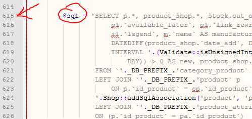

Sorry for my English, maybe I not be explaining this very well, I'll try to explain with pictures.
I want to load the $sql in my template to check the Query structure
1 I am referring to www.domain.com/classes/category.php and getProducts function, which is on line 560.

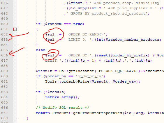

The variable $ sql is on line 615 and concatenated with line 652-653 or 656
So if I can display on smarty the <p>Query Test: {$sql}</p> to see the result in the product-list.tpl, I will be able see how the query is built, so I can see if there is an error in my development
¿How can I pass the $sql (Only the Query) to my template?
I think there should be some way to check the query builts
Thanks!
