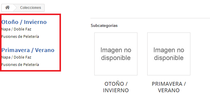

hunterF Posted July 9, 2014 Share Posted July 9, 2014 Hi!! how could I add the block category in the left column. I need the block that appears in category.tpl within the product-list.tpl display. Someone can help me? thank you very much Link to comment Share on other sites More sharing options...

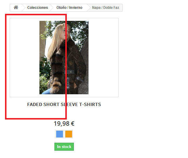

vekia Posted July 9, 2014 Share Posted July 9, 2014 i don't understand you asked about blockcategories in left column (it appears there by default) then you pasted image with product item from category page can you shed some more light please? i don't understand you asked about blockcategories in left column (it appears there by default) then you paster image with product item from category page can you shed some more light please? Link to comment Share on other sites More sharing options...
hunterF Posted July 9, 2014 Author Share Posted July 9, 2014 thank you very much for your reply. I want that menu does not disappear when between products within each category. I want the menu always visible. The second photograph are the products of the autumn / winter category, the list of products and the menu disappears. Thanks!! Link to comment Share on other sites More sharing options...

vekia Posted July 12, 2014 Share Posted July 12, 2014 hello this menu, it's a block categories module? if so, try to go to modules > positions search for displayLeftColumn hook, on this list you should find block categories module, click on edit button near it make sure that module hasn't got "exception" defined for category pages also it's worth to check if left column is enabled on category pages (on theme preferences page) Link to comment Share on other sites More sharing options...
jmeca Posted July 24, 2014 Share Posted July 24, 2014 I had this same problem and I've broken my head and looking for the solution is quite simple. There you go admin-> modules-> blockcategories-> configure and change current category by category start.I attached a photo to make it simple 1 Link to comment Share on other sites More sharing options...
vekia Posted July 24, 2014 Share Posted July 24, 2014 what about exceptions? have you checked execptions for that module under modules > positions (display left column modules list) Link to comment Share on other sites More sharing options...
hunterF Posted July 25, 2014 Author Share Posted July 25, 2014 thank you very much to all! The solution is what explains jmeca Thanks!! thank you very much to all! The solution is what explains Thanks!! Link to comment Share on other sites More sharing options...
