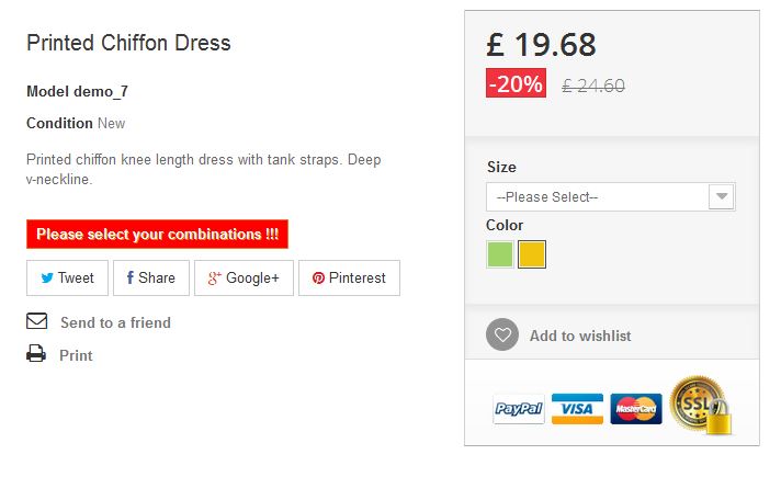

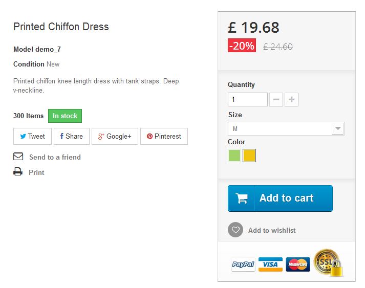

mickeyboy1 Posted October 18, 2014 Share Posted October 18, 2014 Well guys i searched around and found this: http://www.prestashop.com/forums/topic/274265-how-to-enable-choose-size-text-in-drop-down-on-combinations/?p=1754797 I commented out the original code and added this in my product.tpl <option value="choose" selected="selected" title="--choose--">{l s='--Please Select--'}</option> {foreach from=$group.attributes key=id_attribute item=group_attribute} <option value="{$id_attribute|intval}" {if (isset($smarty.get.$groupName) && $smarty.get.$groupName|intval == $id_attribute)} selected="selected" {/if} title="{$group_attribute|escape:'html':'UTF-8'}"> {$group_attribute|escape:'html':'UTF-8'} </option> {/foreach} Then in back office i changed translation to: This combination does not exist for this product. Please select another combination.= "Please select your combinations !!!" And lastly in themes/my_theme/css/product.css on line 747 changed colour to red background-color: #ff0000; Seems to work with mutiple dropdowns as well Please back-up before trying this on your own site.. 1 Link to comment Share on other sites More sharing options...
benedettopresta Posted October 18, 2014 Share Posted October 18, 2014 You said you changed translation, I guess you changed the out of stock one, but then if you really have a product out of stock it will show please select? or can you change it only for the required product? Link to comment Share on other sites More sharing options...
mickeyboy1 Posted October 18, 2014 Share Posted October 18, 2014 I changed this one: This combination does not exist for this product. Please select another combination.= It originally said something like " The product is not available in this combination but is available in another" I havent tried this with lots of combinations so will be glad to hear from others. Shall do some more testing on this and report back Link to comment Share on other sites More sharing options...
mickeyboy1 Posted October 19, 2014 Share Posted October 19, 2014 This only seems to work if you have attributes which are dropdowns. It does not work with radio buttons or the colour picker. Have removed this from my test site Maybe someone will make a module for this!!! 1 Link to comment Share on other sites More sharing options...
