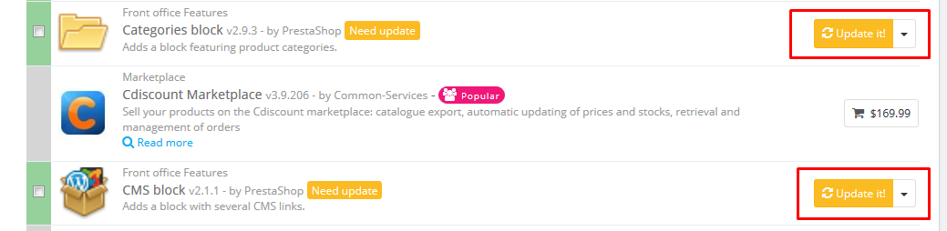

Starky04 Posted June 8, 2014 Share Posted June 8, 2014 I am working on a Prestashop installation for a client and I wish to disable the automatic module update checks. I have customised a couple of the modules and updating them would overwrite the my changes. Furthermore, when an update is available, the option to configure a module is replaced with the option to update it. This is very irritating, should users be forced to update modules before they can configure them? How do I disable the update checks? Link to comment Share on other sites More sharing options...

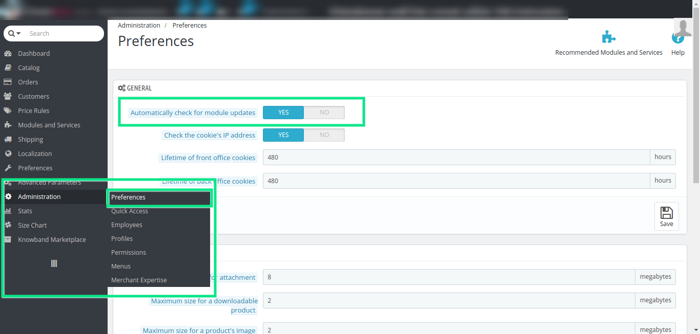

chirag_0110 Posted August 2, 2016 Share Posted August 2, 2016 Hi you can desable automatically check for module updates in BO ADMINSTRATION > Preferences option > GENERAL > Automatically check for module updates=NO Hi, I can't found this option in BO in prestashop 1.6.1.6. can anybody know where i find this option ? Link to comment Share on other sites More sharing options...
Knowband Plugins Posted August 2, 2016 Share Posted August 2, 2016 You can refer to this attached screenshot for the solution. Hope this helps you. Link to comment Share on other sites More sharing options...
chirag_0110 Posted August 2, 2016 Share Posted August 2, 2016 You can refer to this attached screenshot for the solution. Hope this helps you. Thanks Knowband. It's work for me. Link to comment Share on other sites More sharing options...
