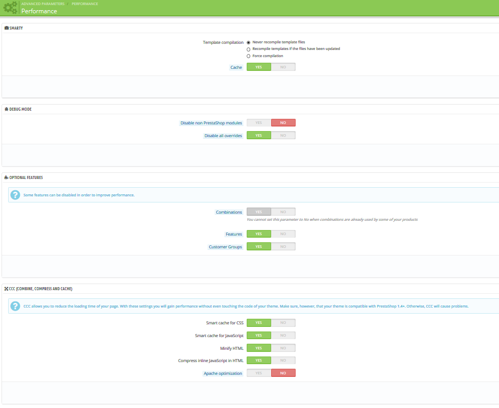

PrestaHeroes USA Posted May 29, 2014 Share Posted May 29, 2014 make sure to set apache optimization to 'yes' (see your screen shot) this won't fix all your issues but it's best setting.. also for slow pages, config/defines.inc.php set to true define('_PS_DEBUG_PROFILING_', true); then visit your slow page, and scroll to bottom to see profiling...this can help you isolate exactly what the hang up is (make sure to set to false when done. 1 Link to comment Share on other sites More sharing options...

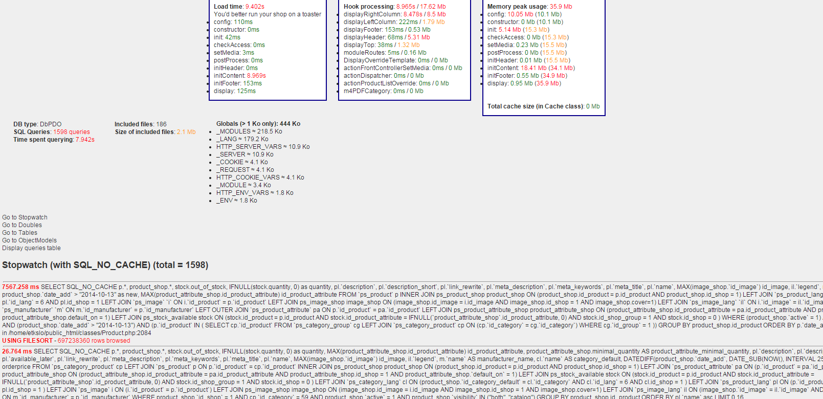

giuliopowa Posted November 7, 2014 Share Posted November 7, 2014 hello,my site now is very slow.can you help me?i saw that i have many sql queries (1598)and many rows browsed Link to comment Share on other sites More sharing options...
giuliopowa Posted November 7, 2014 Share Posted November 7, 2014 i solved , clean the tables Link to comment Share on other sites More sharing options...
