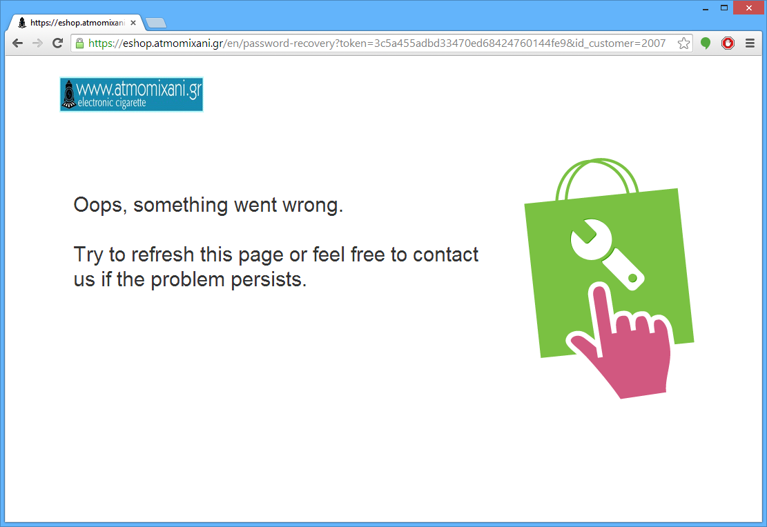

I just go live a new eshop migrated from Virtuemart and I am facing the following problem with some customers who are trying to recover their password. They are getting and email with a Url to click in order to recover the password like the following one
https://eshop.atmomixani.gr/en/password-recovery?token=3c5a455adbd33470ed68424760144fe9&id_customer=2007 but for some of them as soon as they click on the url they redirect on a page which informs them that "Oops something went wrong. Try to refresh this page or feel free to contact us if the problem persists." like the attached picture.
Can anyone help me on that because I cannot understand where is the problem?

I'm having the identical problem, leading to a 500 internal server error. There is something about the link that is just not working.
I had to import more than 700 customers without their passwords, so all of them will need to reset it when they return to us (the previous cart system was hosted with no server-side access and passwords could not be exported).
I have tried changing the URL settings in back office, checking the email link each time, and everything returns a 500 error. I can't seem to find any information out there about this. Every time I check something it's about customers not receiveing the email in the first place, or about resetting admin passwords.

It might be an issue with your theme.
If you have SEO URL's active, try deactivating them and see what you get.
Or in case, you might not have SEO URL's active, the theme might have them hardcoded and as such might not be properly accessing the recovery site. In that case, try activating them.
In other words, the URL is the first thing I would look into, if it's properly resolved. Also check, if it's set to the one in the email under SEO URL's in the backend.
In case of a 500 Internal server error, check your server logs first for further infos of what's going wrong.
