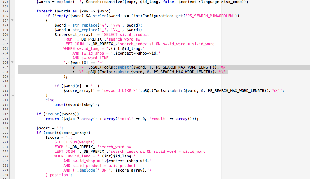

Yes, you can edit the find() method of the search.php class, lines 207, 208
						? ' \''.pSQL(Tools::substr($word, 1, PS_SEARCH_MAX_WORD_LENGTH)).'%\''
						: '\''.pSQL(Tools::substr($word, 0, PS_SEARCH_MAX_WORD_LENGTH)).'%\''
CHange it to
						? ' \'%'.pSQL(Tools::substr($word, 1, PS_SEARCH_MAX_WORD_LENGTH)).'%\''
						: '\'%'.pSQL(Tools::substr($word, 0, PS_SEARCH_MAX_WORD_LENGTH)).'%\''
Please note that your search might become slower

Thanks. Worked for me too.
I have about 500 products, and the search works fast with this modification.
In my case, the problem was that i would search for :    Nokia X6 or nokia x7  or anything with an X, and would not come up at all.
Now it works.

1 Hello Nemo, I found the files that you tell me, manon difference I see from what you've posted, compared to what I have??
THose are the lines, correct. They are different, notice the % symbols preceding words in my snippet

You can try this, in search.php, find() method
$eligible_products = array_intersect($eligible_products, $eligible_products2);
Set it to array_merge, but notice search results will be more loose
