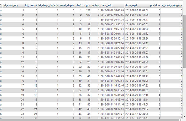

Hi All
I missed Ron Marales earlier reply to this topic and had a look at the values in the "ps_category" table again.
In the "is_root _category" field my problem category had a value of "1"
The only other category with a value of "1" is "home"
When I looked at the problem category in the back office it was still showing in "home".
When I go into edit,  the category tree is is still visible.
However when I now edit any text, it's moved to "root" and the category tree has disapperared.
When I changed the value of "is_root_category" to "0" it moved back to "home".
All seemed good then I tried it again.
This time it got stuck in root and wouldn't move back when I switched the field values.
Then I noticed that the "id_parent" field value was showing as "48" which is assigned to "root"
Changed it back to "1" which is assigned to "home".
It now moved back to "home" and was editable and showed the category tree box again.
I had been through this in a previous post I made in this topic but I must have missed that the value of "id_parent" was also being changed.
There must be an error in the code under certain conditions when a category text edit is saved, and the values of "id_root_category" and "id_parent" are written to the database.
So to recap, check the "ps_category" table and make sure that both "id_parent" is not "48" and "id_root_category" is not "1"
Cheers
deepee

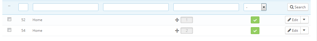

Look this image
I was the one that originally posted this question. Mine was an upgrade from 1.5 to the new 1.6 and not a multi-store. I ended up paying for Prestashop's service plan and they fixed it right away. I wish I could tell you what the fix was, I only know that they were able to fix it right away and it has not re-appeared.
  • 2 weeks later...
Hi guys! Yesterday I faced the same problem.
It seems the problem appears after you changed the Home category from category with ID #1 to any other.
Later, when you edit some subcategory it tries to assign itself to the category #1 which no longer exist in your shop. Probably this caused the problem.
Solution:
2) As @PrestaShop Apprentice noted above go to the PhpMyAdmin, choose ps_category table, find lines corresponding to the "wrong categories" and set id_parent to your true Home category ID (e.q. 2). See this image.
3) Set is_root_category to 0 (zero) to all categories except you current Home category (Home category should have value 1).

Finally, testing around with categories on my development site ( 1.6.0.8 ).  After editing one of my categories, it moved out of home under root.  This bug hasn't been fixed.  Starting to feel hopeless with this 1.6 version.
Hi All
Cheers
deepee
I checked this test site again after a break. Unfortunately the issue had returned.
However, I think I've found a workaround.
I am upgrading from 1.5.6.2 to 1.6.0.8
I checked the database tables in the 1.5.6.2 production site (as above) and found that my problem category's value in "is_root_category" was 1 when it should be 0.
In my 1.5.6.2 site this does not cause any problems so I never noticed it before.
The problem arose when I upgraded.
I changed the category field values before running 1-click upgrade.
After the upgrade I was able to edit the problem category description, change it's ordered position etc. without experiencing any issues.
It seems that the bug has something to do with wrong values being inhereted from the version that is being upgraded. Editing the database within 1.6.0.8 seemed to work but after a while it reverted for some reason.
So check that your "ps_category" tables are correct before upgrading and hopefully it will work for you.
Cheers
deepee

ive got this problem after updating to 1562 from 1531. Only categories with "is_root_category" tag = 1 in ps_category were affected, so it was a easy fix - rolled back database just before editing categories and changed "is_root_category" tag to 0 for all categories exept home.
thank you all for helping in this topic

Does this fix work on 1.5.6.2 because I just messed up my site because of this issue?
EDIT:
Managed to sort out the initial issue with phpmyadmin doing what was told here and after that I kept getting 'not found'. Obviously you have to go in the category and save it again to get it working in FO.
Hope I won't get this issue anymore... 1/2 day with my store offline..

So just to be clear, this problem that was noticed in April just broke my store completely, including all links that point to my store PERMANENTLY.  This is truly absurd, but I don't know why I would expect anything different from PS.
It's still not clear to me how to even fix this.  I now have two root categories, one of which with ID2 that is the old Root/Home category and ID6 with all the physical products in my store and the subcategories.  What exactly do I need to do to fix this mess.

yes i looked, i use store manager. the directories of those edited categories moved out from the tree, sitting in root folder each of them, not under home in some directory or sub directory where they belonged before editing. i think someone with enough knowledge can move them back. i could not. i recomment to install latest version that don't have this bug but has a problem with validation process of the order in the end, too long and sometimes goes into error 500 because of that.
