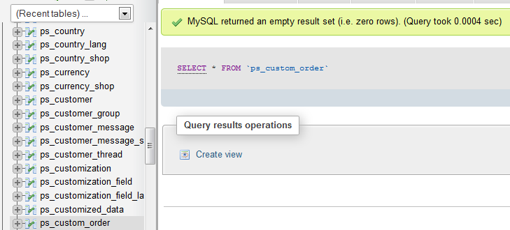

banditbirds Posted April 28, 2014 Posted April 28, 2014 Hi karthik, Here is my code, php: <?php $name = Tools::getValue('name'); $variablename1 = "INSERT INTO`"._DB_PREFIX_."custom_order` ('request_details`) VALUES('{$name}'); "; if (!Db::getInstance()->execute($variablename1)) die('Error etc.)'; ?> Which is being called from my tpl: Please enter you custom request details here: <form > Request Details: <input type="text" id="request_details" > <input type="submit" id="submit"> </form> <script> {literal} $('#submit').click(function(){ var name=$('#request_details').val(); $.post("insert.php",{name:name},function (result){ location.href('http://www.banditbirds.co.uk'); }); }); {/literal} </script> And here is my table - custom_order (image attached) Thanks! Share this post Link to post Share on other sites More sharing options...
