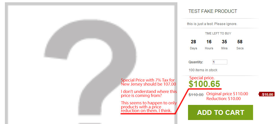

I have a product for $110.00 - base price.
I put a discount amount of $10.00
So final product should cost $100.00
This is fine for products with no tax rule on them...I've got a tax rule set up for New Jersey...7%...so when I log in as a customer with a New Jersey Address...these are the figures I get on the product page
Original price: $110.00
Special Price: $100.65
With a 7% tax I should be getting $107.00 as the final price.

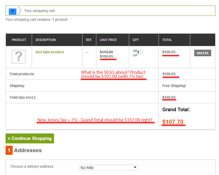

Then on the cart checkout...I'm getting a grand total of $107.70 (free shipping)....where is the 0.70 coming from?? It seems like it's calculating the tax based on the original price $110 * 7% = $7.70 (so grand total $107.70) - should the tax be based on the original price? If so that's fine...but why does the product unit price on the checkout and product page show as $100.65
It will show all the right prices if you're NOT logged in or if you're logged in with an address that is NOT from New Jersey.
See screen captures:
