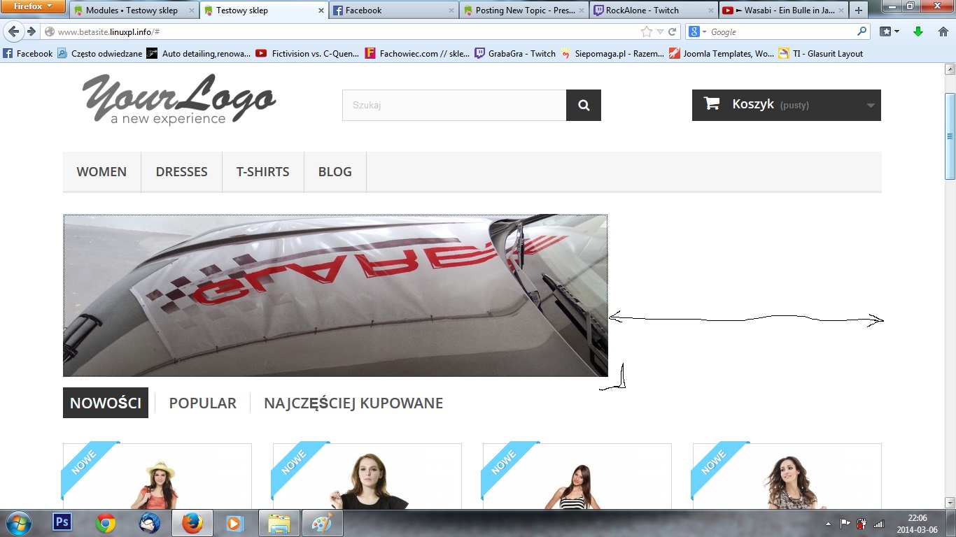

Hi there,
I would like to know if there is any possiblity to change size of the main picture, so that it will be 1170 px width and 350 px height (see attached picture).
In beta it was possible, but all descriptions were put under the picture. Now I can't set the full width of the picture
Any suggestions ?

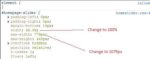

ok, so you do need to edit the css to make the css slider fill the width,
so the "Max-width" setting in the module itselfs seems pointless.
Edit your default-bootstrap/css/modules/homeslider/homeslider.css file.
The first few lines you can edit  these lines as I have.
						Home Page Slider
#homepage-slider {
  padding-left: 0;
  padding-right: 0;
  margin-bottom: 14px;
  width: 100%;               /* Change this to 100% */
  max-width: 1170px;         /* Change to 1170px (Full width) */
  max-height: 448px;
  overflow: hidden;
  position: relative;
  z-index: 1;
  float: left; }

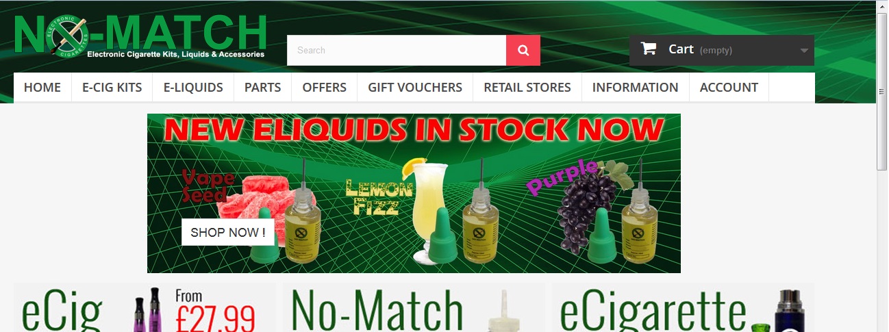

See my dev site here
http://electroniccigarettenorthwest.co.uk/ps1604/

Forget the above method...
Doing that alteration, clear cache and load the page. IT WORKS.
reload the page again, and its back to the smaller size.
messed up or what :/
It seems the jquery function may be adding some css rule or just resizing it ?
Edited by MerseyRay (see edit history)

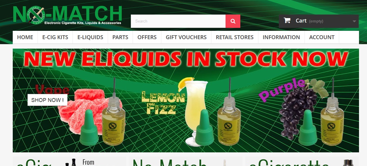

Ok so turning off cache and turning On Force Compile works. But won't it slow down the site ? After switching cache on again the picture gets back to it's smaller size. I don't really know why it's not possible to set the width I need from the BO. Switching off module which is next to for example slider should give you a chance to set the width you need. Without this I think that Live Edit etc. has no sense.

It seems to be ok on my site now :)
Yes it seems solved on my site :)

The first lines of you homeslider.css should look like this.
						Home Page Slider
#homepage-slider {
  padding-left: 0;
  padding-right: 0;
  width: 100%;
  max-width: 1170px;
  max-height: 448px;
  overflow: hidden;
  position: relative;
  z-index: 1;
  float: left; }
Yours looks like this
						Home Page Slider
#homepage-slider {
  padding-left: 0;
  padding-right: 0;
  width: 66.6%;
  max-width: 779px;
  max-height: 448px;
  overflow: hidden;
  position: relative;
  z-index: 1;
  float: left; }
This is the first style that is applied, the media queries are after this and for smaller screen sizes.
