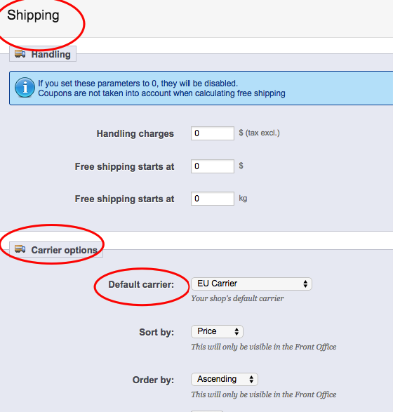

EDIT: My Mistake, default carrier,not default payment method...
Hi Sabio,
In PS 1.6, go to Shipping->Preferences, scroll down and there you have a field default carrier
in PS 1.5, go to Shipping->Shipping, scroll down and there you have a field default carrier.
Hope this helps,
pascal
Edited by PascalVG
My mistake: Default carrier, not default payment method... (see edit history)
