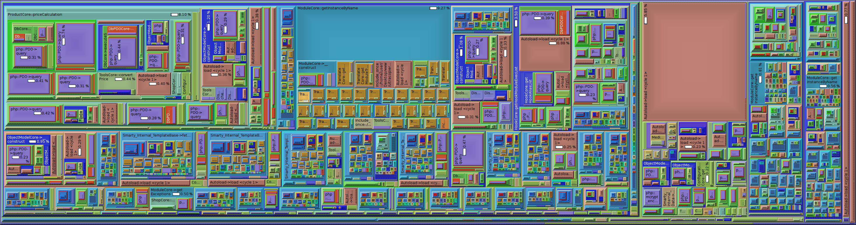

No, slower because it's not optimised.
To speak on same base: fresh install of Prestashop have on my home computer (then very correct: core i7, 16GB of memory, SSD), page time around 100ms, that's mean 10 requests/s on one core. In comparison of my own php script (20000req/s) it's very slow. And my optimized php script is around 60000requests/s.
xdebug show very slow time is only into php (normal, the database is empty).
Here you have 2 not very old profiling:
http://www.first-world.info/wp-content/uploads/2012/06/profiling-of-prestashop.png
http://www.first-world.info/wp-content/uploads/2012/06/profiling-of-prestashop-tree.png
I'm sys admin of more than 10000+ french e-commerce, and at this scale it's too wast of money. An good resolution for 2014 can be optimize your product, because it's so bad too have correct product but with so poor performance.
The best way it's do like phoronix, track the performance and performance regression. The security and performance it's not extra part of an project. But need be included into the base.
