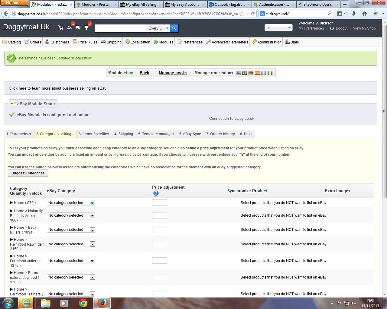

its seems to install correctly and connects to ebay. I add my credentials and ebay store name ect. press save then it says that its configuring categories.
At this point it tkes 15 seconds or so and times out. this message opens in a new window, when i look at the prameters page its says categorie updated so i move to categories tab and press suggest categoies and again it times out.

Have you a lot of categories?  I've found the Suggest Categories function can take quite some time; it might be hitting the maximum execution time limit.  Is there anything in your website error_log that might confirm this?
If you have access to your php.ini, there is a setting in there for the time limit.  Alternatively, try adding
ini_set('max_execution_time', 300); //300 seconds = 5 minutes
near the top of .\modules\ebay\ajax\suggestCategories.php

I had this problem and tried all the suggestions but no result.  Then I found the answer!
There is an issue if you are logged into admin using SSL.  It causes an XMLHttpRequest cannot load error which gives the spinning wheel.
Hopefully this solves your problem too.
