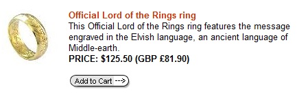

luke_devon Posted November 12, 2013 Author Share Posted November 12, 2013 (edited) Hi As I checked this would be a requirement of some shops where they do not have access to use PAYPAL for their own currencies. Appreciate it , if you guys help us on this to add max-2 currencies for a product . Actually second currency just for display the prices from their own currency. 1st currency will involve with direct transaction. (Please refer the attached image ) Could you please explain how is this requirement affecting to SEO ? Many Thanks Luke. Edited November 12, 2013 by luke_devon (see edit history) Link to comment Share on other sites More sharing options...

luke_devon Posted November 13, 2013 Author Share Posted November 13, 2013 (edited) Hi El Patron, Thank you once again consider about my request. Actually I have shared one screen shot and an example in one my previous post , someone has done with prestashop 1.4. I'll attach it again. (eFVda.jpg) Here you can see the price $125.50 (GPB 81.90 ), British customer can see the actual price from British pound , but the transaction will be occurred on USD. hence USD will be the base currency of the store. http://stackoverflow.com/questions/16917170/prestashop-1-5-display-product-price-in-two-currencies-at-the-same-time Regards Luke Edited November 13, 2013 by luke_devon (see edit history) Link to comment Share on other sites More sharing options...
