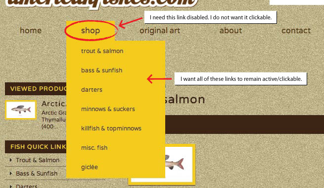

bobbything Posted September 16, 2013 Share Posted September 16, 2013 (edited) Hello all - I've searched and searched and cannot seem to find an answer to this very frustrating issue I'm having... Basically, I have my top menu navigation set up as a mix of CMS links and Category links. What I'm trying to do is disable the Parent category links only for for those categories that have drop-down sub-menu categories. If anyone has any idea on how to hack this, I'd appreciate it. I have attached a screenshot for reference. I'm using 1.5.4 Edited September 24, 2013 by bobbything (see edit history) Link to comment Share on other sites More sharing options...
vekia Posted September 21, 2013 Share Posted September 21, 2013 by default it isn't possible to do it easily. it's necessary to modify top horizontal menu .php scripts btw. you said: but this is available by default so you need to remove link from first element only Link to comment Share on other sites More sharing options...
bobbything Posted September 24, 2013 Author Share Posted September 24, 2013 Okay, so I came up with a solution for anyone who has been looking for this. It doesn't require hardly any reworking/removing code. Open this file: yourshop/modules/blocktopmenu/js/superfish-modified.js Simply place this line of code at the bottom of the "superfish-modified.js" file and violá! All parent links are disabled. $(document).ready(function(){ $('.sf-with-ul').bind('click', false); }); Whenever drop-down categories are created in the menu, they're given a class of "sf-with-ul". All this is doing is using jquery to bind a false return on click for anything on that page with class "sf-with-ul". It will not affect any menu links without a drop-down menu. Hope this helps. I've noticed this has been an issue since 2009 from searching these forums. I will mark this thread [sOLVED]. 3 Link to comment Share on other sites More sharing options...
vekia Posted September 24, 2013 Share Posted September 24, 2013 hello thank you for your solution. but if you check page source you will see that anhor is still there Link to comment Share on other sites More sharing options...
bobbything Posted September 24, 2013 Author Share Posted September 24, 2013 Hi vekia - If you're referring to the link, yes, the link is still there, but it isn't active. I am assuming you're using the "blocktopmenu" that comes standard with Prestashop. So, if that's accurate, this piece of jquery should disable the link from loading onclick; even though it still looks like it's active. I've tested it on my site and it works great. I'm happy to help any way I can. Link to comment Share on other sites More sharing options...

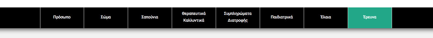

INFOIT Posted February 15, 2017 Share Posted February 15, 2017 Hy everyone, We have a web on www.top-zabava.com and we use TM mega menu and on TOP menu we have KARNEVAL and then drop down meni with subcategory - PUST PO TEMAH....AND then another SUB-sategories...that we dont want to have it there..... It is there some option that it seen only first sub-category and no more sub-cat... ? Thank you for all help, Tadej Link to comment Share on other sites More sharing options...
