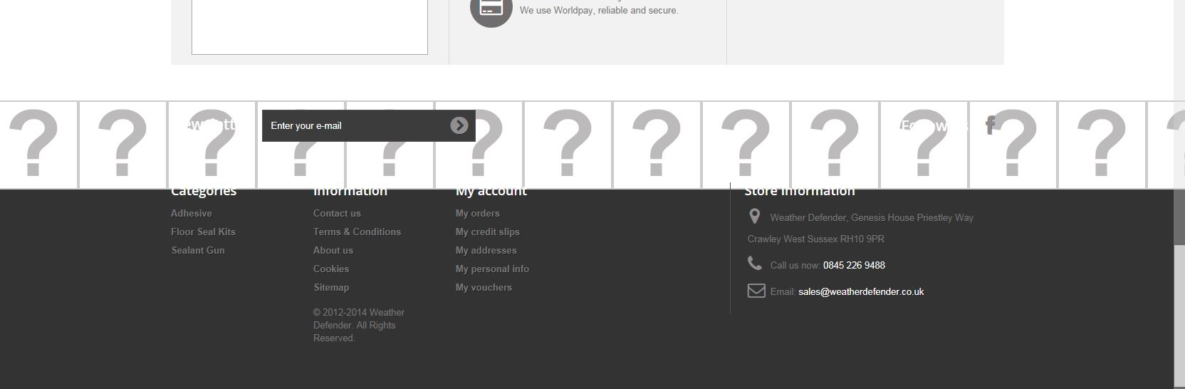

hello
you attached screenshot with "top" section, there is no image - you've got right (weridy question marks)
but ... product pictures works well? categories too?
i just wondering, you see this question mark for each page in your store? or only for certain pages?
so you've got some issue with CSS, youv'e got this path defined in global.css file, take a look:
#main-wrap {
background: url(../imag/tail-main.gif) left top repeat-x #F8C932 /* 1d1a16 */;
width: 100%;
padding: 0;
overflow: hidden;
backgrund: url(../imag/tail-main.gif)
you have to change /imag/ to /img/ there

I changed it to img, but now the background became black!
it will be painfull work because you have to do this... for all CSS files and all /imag/ instances ;/
Ok thanks I shall see to it
But I think that folder imag, was created through some code error because it wasnt there to begin with
Anyhow I shall revert to you once I check each of the files
I fixed the issue, however if you go to the console in Chrome inspect element, it displays a list of CSS files as 404 not found
In fact, all of these files are available in the exact directory, although they may be blank
Any ideas on how this could be sorted out

Peter your issue is different.
Question mark images are displayed because there is no image in that path.
And code causing that is
<!-- MODULE Block contact infos -->
<style type="text/css">
.footer-container {
    background: url('../img/footer-bg.png') repeat-x scroll 0% 0% #333;
Not sure why and were is that included maybe some tpl file, but similar code exists in global.css.
