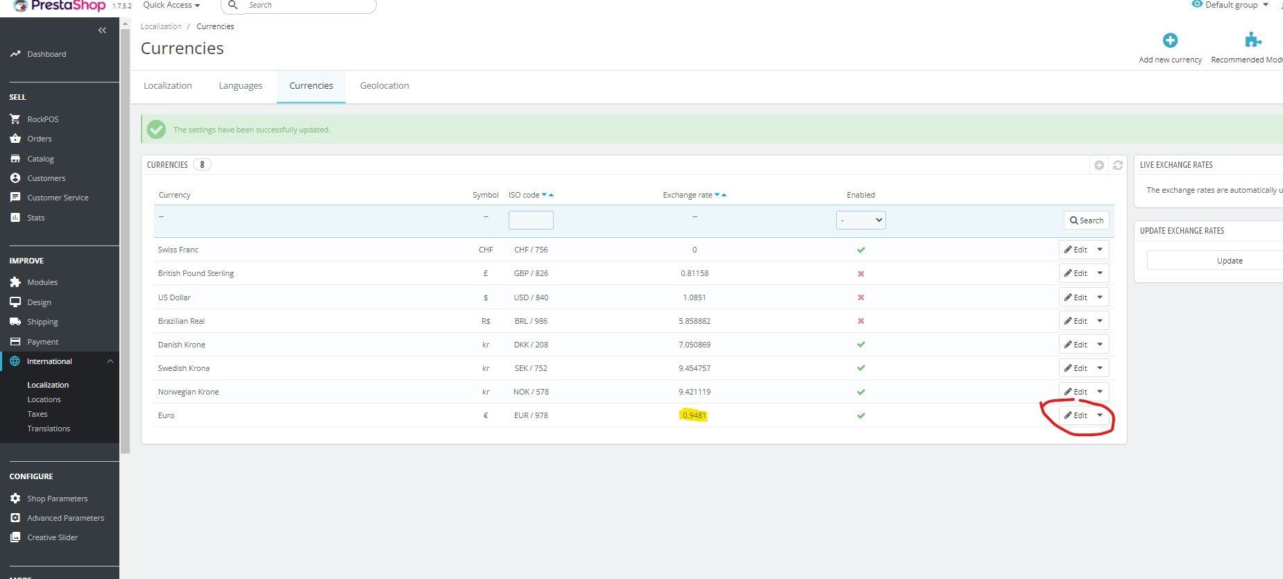

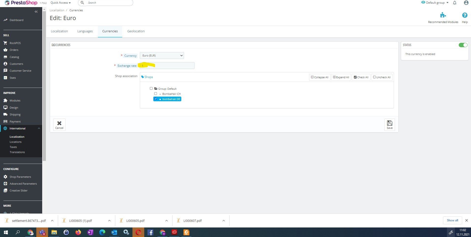

no it does not seem to be related to zones/country settings. it is because there is a different default currency for each Multishop.
And this default currency is always set to 1. In the currency overview it show the correct conversion 0.9481 but when I click edit it shows 1.
Also changing the value manual to 0.9481 does not help. it seems to be saved and the screen jumps back to the currency overview.
going back to details still 1 is shown
