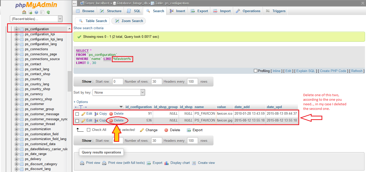

NOSaint Posted July 23, 2013 Author Share Posted July 23, 2013 Thank you again! Link to comment Share on other sites More sharing options...
tony_mik Posted August 13, 2015 Share Posted August 13, 2015 Thank you for this usefull information. It solved my problem. 1 Link to comment Share on other sites More sharing options...
typoman Posted September 8, 2015 Share Posted September 8, 2015 Thanks for the Screenshot tony_mik. That was really helpfull and i could solve my problem on a upgraded prestashop. Link to comment Share on other sites More sharing options...
tony_mik Posted September 8, 2015 Share Posted September 8, 2015 Thanks for the Screenshot tony_mik. That was really helpfull and i could solve my problem on a upgraded prestashop. I'm glad I could help. Link to comment Share on other sites More sharing options...
NewLizard Posted June 10, 2016 Share Posted June 10, 2016 Thanks for the screenshot image. that did the trick for me. Link to comment Share on other sites More sharing options...
