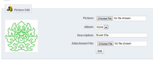

I need someone to write a piece of code for this:
Explanation:
I want to upload a picture, choose which album to use, have a description and a file attached to the picture. I want to click on this picture on my website and download the file attached to it.
Is there anyone that can help me with this?

I understand that, PSfever.com. I have written the piece of code that you see in the picture, by have no idea how to write the bit that does the database. That is the only bit of information that I am looking for.
Here is the code as it is at the moment:

vekia, a while ago you helped me to do a CMS page with free designs, done in a table format, which works well, by the way.
I want to display these pictures on the Free Designs, but want to do it with a module instead of a CMS page. The module is the azgallery module, with some modifications. It will be easier to upload the designs this way, than to try and resize each picture manually to fit into the table - it looks better.
In hindsight, I want to be able to click on the name,not the picture.

so my questions is, how you want to attach the file to each picture?
as far as i know there is no option for that, so you have to modify the module
and this is what you expect, right?

That is right, vekia. I have already done some modifications to it and called the module something else, like freedesigns instead of azgallery, but I cannot get the zip file to attach to the picture, like I did in the CMS page called Freebies

and what you think about additional field where you will put the url to the file that you will upload manually via FTP ? it's easier than huge modification of the module to support "uploading" and attaching files... just let me know what you think about that

vekia, that is fine with me, as long as I can get the zip file attached to the picture or the name thereof. I don't like the CMS page I created, as I will have to keep creating pages, the more free designs I have. With the modified module it will not be the case.
Am I wrong in thinking it is just another line to be written to the table, the code which is in post #3 above?

well, it's necessary to create new field in the datbase you mentioned above.
I don't know how the full module code looks like, but i think that you should also change the object definition of course only when this module is based on it. If it isn't, you have to modify form to upload the picture + scripts to insert the "file url" field to the db
