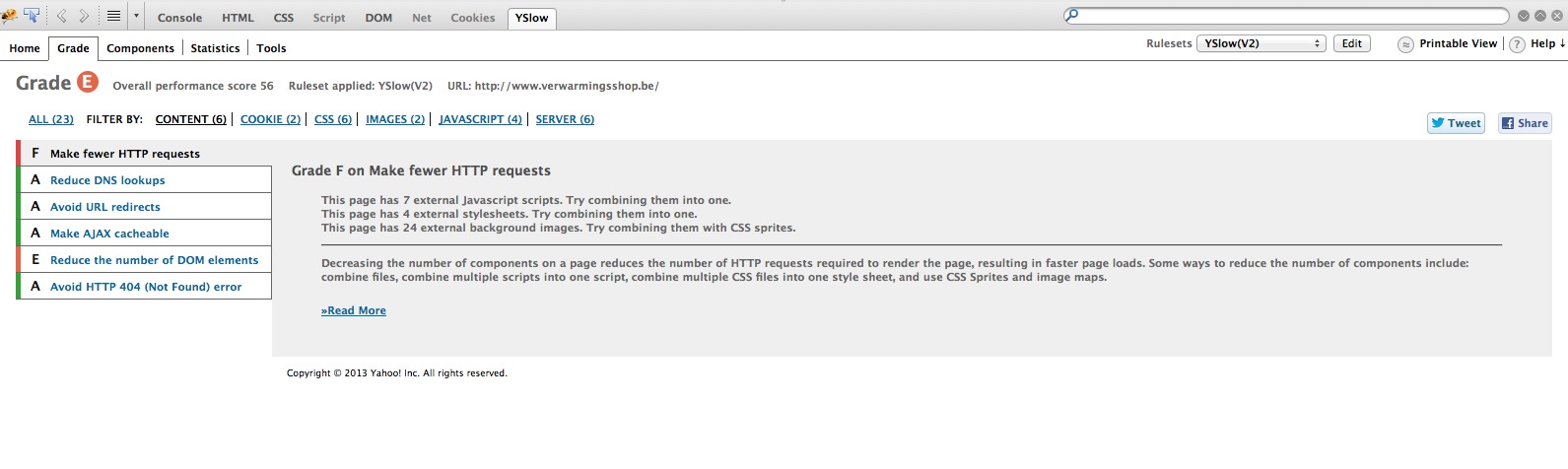

Optimus_Sam Posted June 25, 2013 Share Posted June 25, 2013 (edited) Hi guys, I'm using PS 1.5.4.1 and my site is getting a Grade F using Yslow (Firebug) regarding the HTTP requests. But i don't know what this means. Below is a screenshot of my test results. Questions: 1) how to combine 7 external Javascript scripts into one? 2) How to combine 5 external stylesheets into one? 3) How to combine 24 external background images using CSS sprites? FYI i don't know what javascripts, external stylesheets, css sprites means :-) So if you do have a possible answer for me. I'd be much obliged if you'd use baby-steps in your communication . Does anybody (or King Vekia) have some tips for me to solve this problem? Thank you in advance. Sam www.verwarmingsshop.be Edited June 25, 2013 by Optimus_Sam (see edit history) Link to comment Share on other sites More sharing options...

Piotr Kaczor Posted June 25, 2013 Share Posted June 25, 2013 Answer for 1 and 2 is to use CCC for CSS and JS. Turn-it on, go to Advanced Parameters -> Performance, also try Apache Optimization it has really good effects. Link to comment Share on other sites More sharing options...
Optimus_Sam Posted June 25, 2013 Author Share Posted June 25, 2013 Hey Piotr, Thanks for the reply. But i've already have that turned on. Also the apache optimization... :-( Link to comment Share on other sites More sharing options...

mikewra Posted February 5, 2015 Share Posted February 5, 2015 Hi, If you already turned on CCC, there may well be difficulty with combining all remaining css and js in that it can cause conflicts, e.g., there can be unintended css selector overrides, etc. Or, sometimes you can load js at the end of the page, sometimes not. So it often is trial and error to see what can be combined and what has to be separately loaded. You'd have to go into the cache, combine the css and play with the order to see what works or not and you'd have to change the link name for the new stylesheet in the head of the page to reflect the new combination and remove the calls for the original ones. Cumbersome and time-consuming for what I have experienced as only minimal gains in the past. As for combining background images into sprites, see: http://spriteme.org/ But if you have knowledge of SASS and COMPASS, you can see:http://compass-style.org/help/tutorials/spriting/ I find the latter easier, though, for me, sprites are never a breeze. @Optimus_Sam, from your attached image, it looks like the site in question is http://verwarmingsshop.be It appears that there are other issues playing a greater role in your page load delays. You've got 2 redirects, http://www.zet-shop.be/ and http://zet-shop.be/ And there is a wait of about 1.6 seconds before the server responds. If you review the results for your site here:http://gtmetrix.com/reports/verwarmingsshop.be/p4JOmvX3 I think you'll find a number of time-saving recommendations that would probably serve you better than mucking around with the css and js. Link to comment Share on other sites More sharing options...
