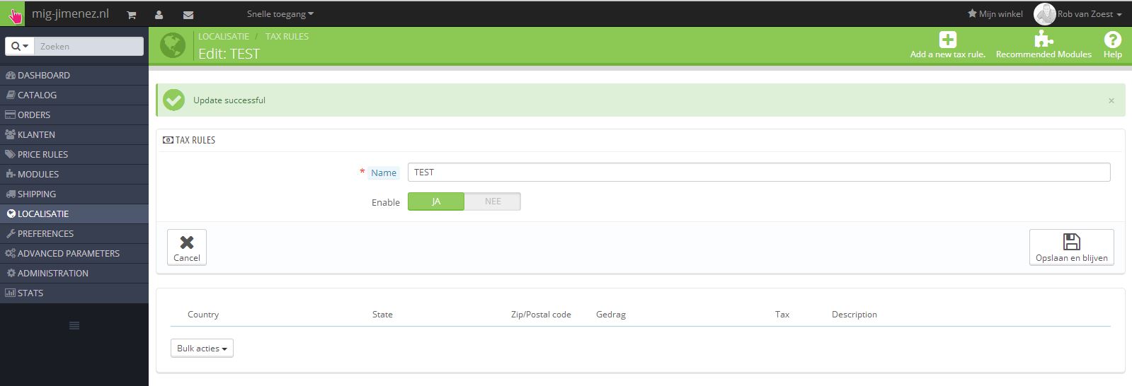

Thank you for this info!!! I have no clue about SQL but after fiddling a bit (and making backups all the time) I succeeded in making it work. This is also a problem in Prestashop 1.6. I think this is a MAJOR problem if this isn't standard altered?!?!
But still the problem remains, I can not change the country to apply the rule in ?!
Edited by rvzoest (see edit history)
