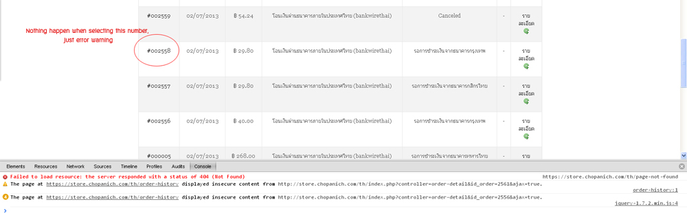

Looks like a javascript issue, In chrome, turn on the dev tools by hitting f12. THen click the details icon. A red mark should appear in the console's bottom right. CLick on the 'console' tab, and paste here the error you get

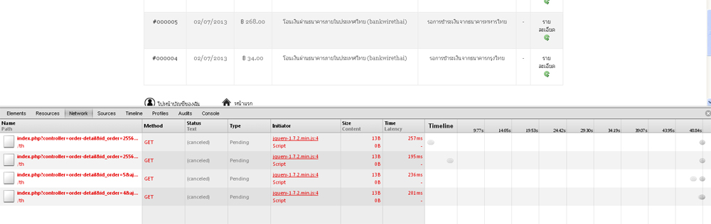

Oh, sorry i misinterpred then, it looked like that one popped out as soon as you clicked. So nothing appears? Would it be possible for you to test it with firebug in firefox? from the last screen, we can only tell that the request was canceled. Are you using friendly urls?

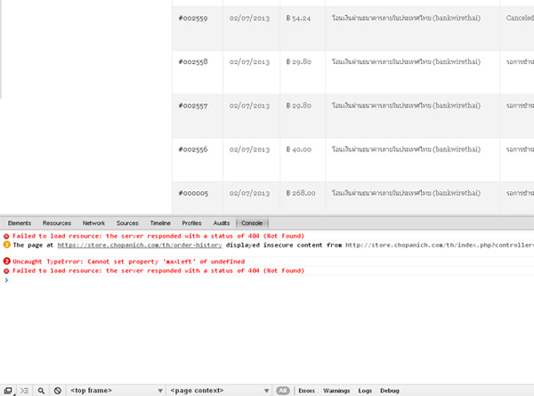

Oh I edit to add that after several checks, I opened the js console (Chrome) again and now it showed an error.. here is (attachment):
Edited by Vank (see edit history)
Hi Nemo, thank you so much! precisely some minutes before your answer, we found one possible solution, that was adding ../ before the order-detail.php.. but that didn't sound that right for me..
Just tried your solution and it works perfectly! Thank you! (template problems as I see).
