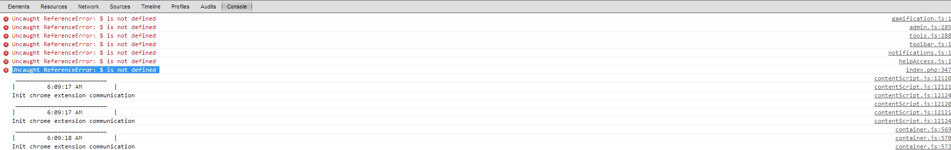

vekia Posted April 25, 2013 Posted April 25, 2013 any error appear? turn on console (in chrome: fn+f12 / f12) and check the error log right after click on "add" button Share this post Link to post Share on other sites More sharing options...
belcoutureco Posted April 25, 2013 Posted April 25, 2013 It shows Uncaught ReferenceError: $ is not defined Share this post Link to post Share on other sites More sharing options...
belcoutureco Posted April 25, 2013 Posted April 25, 2013 (edited) Thanks. I have attached a pic on the error, I need help on this as I totally had no clue on what to do. Thanks a million Edited April 25, 2013 by belcoutureco (see edit history) Share this post Link to post Share on other sites More sharing options...
vekia Posted April 26, 2013 Posted April 26, 2013 it looks like the jquery library isn't included properly can you check the source of your website for jquery library? (right click / show source) hit the link, does it work? Share this post Link to post Share on other sites More sharing options...

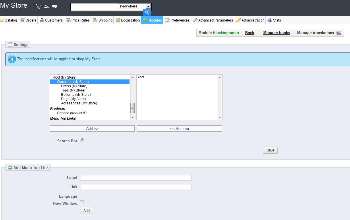

vekia Posted April 26, 2013 Posted April 26, 2013 try to search only "jquery" string. you downloaded prestashop installation package from official website? (prestashop.com) or maybe you use some pre-installator in your webhosting control panel? Share this post Link to post Share on other sites More sharing options...
belcoutureco Posted April 26, 2013 Posted April 26, 2013 try to search only "jquery" string. you downloaded prestashop installation package from official website? (prestashop.com) or maybe you use some pre-installator in your webhosting control panel? I have attached the screenshot of the code with jquery string. It display full page of codes when I click on the link. I installed prestashop from my webhosting control panel, will that caused this issue? I used to install older version of prestashop via the webhosting control panel but does not have this problem. Thanks! Share this post Link to post Share on other sites More sharing options...

vekia Posted April 28, 2013 Posted April 28, 2013 i checked your images once again. You checked front office page source? (it looks like code for front office) you have to check back office Share this post Link to post Share on other sites More sharing options...
