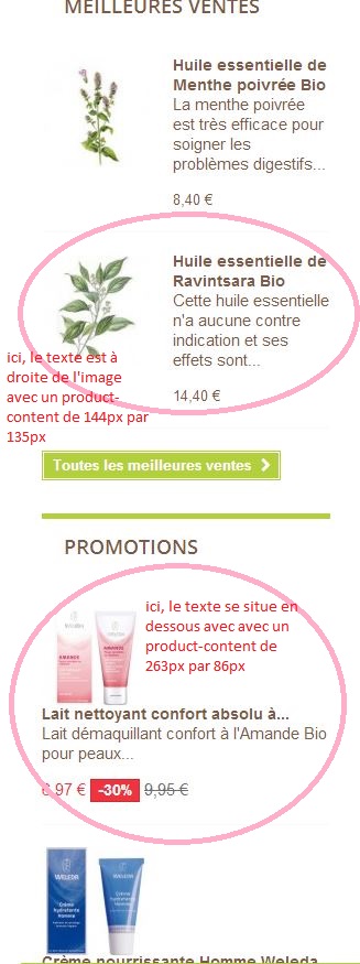

FunkyJunky Posted July 25, 2014 Posted July 25, 2014 Pour clore ce topic, je vais poster les portions de code qui ont été modifiées. /themes/votretheme/module/blockspecials.tpl : <!-- MODULE Block specials --> <section id="specials special_block_right" class="block products_block column_box"> <h4><span>{l s='Specials' mod='blockspecials'}</span></h4> <div class="block_content toggle_content"> {if $specials} <ul class="block_content products-block"> {foreach from=$specials item=special} <li class="clearfix"> <a class="products_block_img content_img clearfix" href="{$special.link}"> <img class="replace-2x img-responsive" src="{$link->getImageLink($special.link_rewrite, $special.id_image, 'small_default')}" alt="{$special.legend|escape:html:'UTF-8'}" title="{$special.name|escape:html:'UTF-8'}" /></a> <div class="product-content"> <h5> <a class="product-name" href="{$special.link}" title="{$special.name|escape:html:'UTF-8'}">{$special.name|escape:html:'UTF-8'|truncate:35:'...'}</a></h5> <p class="product-description">{$special.description_short|strip_tags:'UTF-8'|truncate:75:'...'}</p> {if !$PS_CATALOG_MODE} <span class="special-price"> {if !$priceDisplay} {displayWtPrice p=$special.price}{else}{displayWtPrice p=$special.price_tax_exc} {/if} </span> {if $special.specific_prices} {assign var='specific_prices' value=$special.specific_prices} {if $specific_prices.reduction_type == 'percentage' && ($specific_prices.from == $specific_prices.to OR ($smarty.now|date_format:'%Y-%m-%d %H:%M:%S' <= $specific_prices.to && $smarty.now|date_format:'%Y-%m-%d %H:%M:%S' >= $specific_prices.from))} <span class="price-percent-reduction">-{$specific_prices.reduction*100|floatval}%</span> {/if} {/if} <span class="old-price"> {if !$priceDisplay} {displayWtPrice p=$special.price_without_reduction}{else}{displayWtPrice p=$priceWithoutReduction_tax_excl} {/if} </span> {/if} </div> </li> {/foreach} </ul> <div class="lnk"> <a class="btn btn-default button button-small" href="{$link->getPageLink('prices-drop')}" title="{l s='All specials' mod='blockspecials'}"><span>{l s='All specials' mod='blockspecials'}<i class="icon-chevron-right right"></i></span></a> </div> {else} <p>{l s='No product specials are available at this time.' mod='blockspecials'}</p> {/if} </div> </section> <!-- /MODULE Block specials --> /classes/product.php /** * Get a random special * * @param integer $id_lang Language id * @return array Special */ public static function getRandomSpecial($id_lang, $beginning = false, $ending = false, Context $context = null, $nb_items = 1) { if((int) $nb_items > 4) $nb_items = 4; elseif((int) $nb_items <= 0) $nb_items = 1; if (!$context) $context = Context::getContext(); $front = true; if (!in_array($context->controller->controller_type, array('front', 'modulefront'))) $front = false; $current_date = date('Y-m-d H:i:s'); $product_reductions = Product::_getProductIdByDate((!$beginning ? $current_date : $beginning), (!$ending ? $current_date : $ending), $context, true); if ($product_reductions) { $ids_product = ' AND ('; foreach ($product_reductions as $product_reduction) $ids_product .= '( product_shop.`id_product` = '.(int)$product_reduction['id_product'].($product_reduction['id_product_attribute'] ? ' AND product_attribute_shop.`id_product_attribute`='.(int)$product_reduction['id_product_attribute'] :'').') OR'; $ids_product = rtrim($ids_product, 'OR').')'; $groups = FrontController::getCurrentCustomerGroups(); $sql_groups = (count($groups) ? 'IN ('.implode(',', $groups).')' : '= 1'); // Please keep 2 distinct queries because RAND() is an awful way to achieve this result $sql = 'SELECT product_shop.id_product, MAX(product_attribute_shop.id_product_attribute) id_product_attribute FROM `'._DB_PREFIX_.'product` p '.Shop::addSqlAssociation('product', 'p').' LEFT JOIN `'._DB_PREFIX_.'product_attribute` pa ON (product_shop.id_product = pa.id_product) '.Shop::addSqlAssociation('product_attribute', 'pa', false, 'product_attribute_shop.default_on = 1').' WHERE product_shop.`active` = 1 '.(($ids_product) ? $ids_product : '').' AND p.`id_product` IN ( SELECT cp.`id_product` FROM `'._DB_PREFIX_.'category_group` cg LEFT JOIN `'._DB_PREFIX_.'category_product` cp ON (cp.`id_category` = cg.`id_category`) WHERE cg.`id_group` '.$sql_groups.' ) '.($front ? ' AND product_shop.`visibility` IN ("both", "catalog")' : '').' GROUP BY product_shop.id_product ORDER BY RAND() LIMIT 0, '.$nb_items; $result = Db::getInstance(_PS_USE_SQL_SLAVE_)->executeS($sql); $results = array(); foreach($result as $item) { if($item['id_product']) { $results[$item['id_product']] = $item['id_product_attribute']; } } if(count($results)==0) return false; $sql = 'SELECT p.*, product_shop.*, stock.`out_of_stock` out_of_stock, pl.`description`, pl.`description_short`, pl.`link_rewrite`, pl.`meta_description`, pl.`meta_keywords`, pl.`meta_title`, pl.`name`, pl.`available_now`, pl.`available_later`, p.`ean13`, p.`upc`, MAX(image_shop.`id_image`) id_image, il.`legend`, DATEDIFF(product_shop.`date_add`, DATE_SUB(NOW(), INTERVAL '.(Validate::isUnsignedInt(Configuration::get('PS_NB_DAYS_NEW_PRODUCT')) ? Configuration::get('PS_NB_DAYS_NEW_PRODUCT') : 20).' DAY)) > 0 AS new FROM `'._DB_PREFIX_.'product` p LEFT JOIN `'._DB_PREFIX_.'product_lang` pl ON ( p.`id_product` = pl.`id_product` AND pl.`id_lang` = '.(int)$id_lang.Shop::addSqlRestrictionOnLang('pl').' ) '.Shop::addSqlAssociation('product', 'p').' LEFT JOIN `'._DB_PREFIX_.'image` i ON (i.`id_product` = p.`id_product`)'. Shop::addSqlAssociation('image', 'i', false, 'image_shop.cover=1').' LEFT JOIN `'._DB_PREFIX_.'image_lang` il ON (i.`id_image` = il.`id_image` AND il.`id_lang` = '.(int)$id_lang.') '.Product::sqlStock('p', 0).' WHERE p.id_product IN ('. implode(',', array_keys($results)).') GROUP BY product_shop.id_product'; $rows = Db::getInstance(_PS_USE_SQL_SLAVE_)->executeS($sql); if (!$rows) return false; $products = array(); foreach($rows as $key=>$value) { if ($results[$value['id_product']]) $rows[$key]['id_product_attribute'] = $results[$value['id_product']]; $products[$key] = Product::getProductProperties($id_lang, $value); } return $products; } else return false; } /modules/blockspecials/blockspecials.php public function hookRightColumn($params) { if (Configuration::get('PS_CATALOG_MODE')) return; // We need to create multiple caches because the products are sorted randomly $random = date('Ymd').'|'.round(rand(1, max(Configuration::get('BLOCKSPECIALS_NB_CACHES'), 1))); if (!Configuration::get('BLOCKSPECIALS_NB_CACHES') || !$this->isCached('blockspecials.tpl', $this->getCacheId('blockspecials|'.$random))) { if (!($special = Product::getRandomSpecial((int)$params['cookie']->id_lang, false, false, null, 2)) && !Configuration::get('PS_BLOCK_SPECIALS_DISPLAY')) return; foreach($special as $key => $value) { $special[$key]['priceWithoutReduction_tax_excl'] = Tools::ps_round($value['price_without_reduction'], 2); } $this->smarty->assign(array( 'specials' => $special, //'priceWithoutReduction_tax_excl' => Tools::ps_round($special['price_without_reduction'], 2), 'mediumSize' => Image::getSize(ImageType::getFormatedName('medium')), )); } return $this->display(__FILE__, 'blockspecials.tpl', (Configuration::get('BLOCKSPECIALS_NB_CACHES') ? $this->getCacheId('blockspecials|'.$random) : null)); } Voilà, en espérant que ça aidera ceux qui veulent faire pareil Share this post Link to post Share on other sites More sharing options...
G.E.S. Posted July 25, 2014 Posted July 25, 2014 Le seul soucis c'est les petits réglages à faire dans le .tpl. Si vous n'avez pas l'habitude de modifier les fichiers .tpl cette modif risque de vous prendre beaucoup de temps. Perso j'ai un affichage correct mais avec des différences de design (qui ne viennent pas de mon css) que je n'arrive pas à régler. Share this post Link to post Share on other sites More sharing options...
