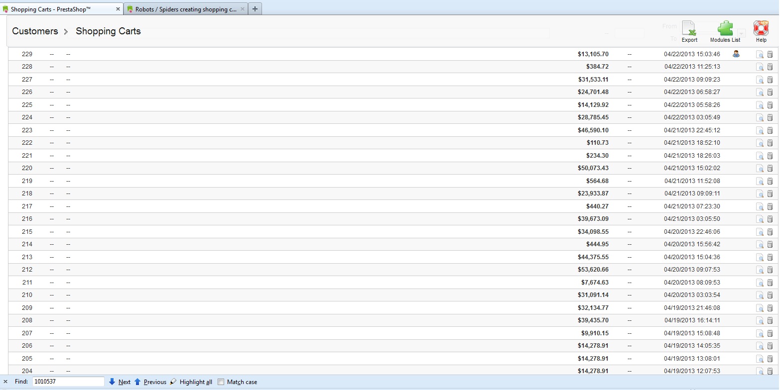

bilalhussain Posted April 22, 2013 Share Posted April 22, 2013 (edited) I have the same problem. Please see the attached photo. Is there any fix for this? PS. I am using the PrestaShop™ 1.5.4.0 version. Edited April 22, 2013 by bilalhussain (see edit history) Link to comment Share on other sites More sharing options...
Guest Posted April 25, 2013 Share Posted April 25, 2013 I have the same problem. Please see the attached photo. Is there any fix for this? PS. I am using the PrestaShop™ 1.5.4.0 version. To be honest I ended up using an IP block and it stopped them dead! Link to comment Share on other sites More sharing options...
