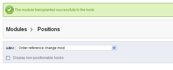

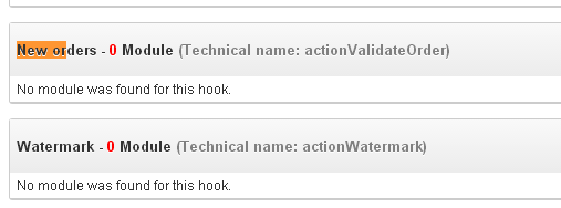

Your error message has nothing to do with the override. Seems like the module isn't hooking into the system.
What you could do after this unsuccesfull installation is 'Transplanting' the module to the hook in your Backoffice->Modules->Positions->Transplant a module.
Choose the module and choose 'New Orders' as the 'Hook into'
Thank you for your support. However, I followed your advise and the module seems to be still unhooked. (As in screenshot)
Do you have any other suggestions?
