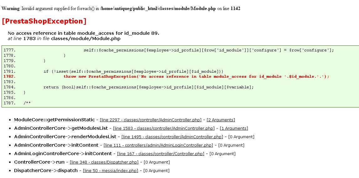

messia Posted November 3, 2013 Posted November 3, 2013 помогите ошибка при переносе магазина на престе 1.5 на другой хостинг и домен вро де бы все скопировал поправил хочу поменять чпу , но выбивает такую ошибку при входе в админку Warning: Invalid argument supplied for foreach() in /home/antiqueg/public_html/classes/module/Module.php on line 1142 [PrestaShopException] No access reference in table module_access for id_module 89. at line 1783 in file classes/module/Module.php 1777. self::$cache_permissions[$employee->id_profile][$row['id_module']]['configure'] = $row['configure']; 1778. } 1779. } 1780. 1781. if (!isset(self::$cache_permissions[$employee->id_profile][$id_module])) 1782. throw new PrestaShopException('No access reference in table module_access for id_module '.$id_module.'.'); 1783. 1784. return (bool)self::$cache_permissions[$employee->id_profile][$id_module][$variable]; 1785. } 1786. 1787. /** ModuleCore::getPermissionStatic - [line 2297 - classes/controller/AdminController.php] - [2 Arguments] AdminControllerCore->getModulesList - [line 1583 - classes/controller/AdminController.php] - [1 Arguments] AdminControllerCore->renderModulesList - [line 1495 - classes/controller/AdminController.php] - [0 Argument] AdminControllerCore->initContent - [line 111 - controllers/admin/AdminLoginController.php] - [0 Argument] AdminLoginControllerCore->initContent - [line 167 - classes/controller/Controller.php] - [0 Argument] ControllerCore->run - [line 348 - classes/Dispatcher.php] - [0 Argument] DispatcherCore->dispatch - [line 50 - messia/index.html] - [0 Argument] Share this post Link to post Share on other sites More sharing options...
